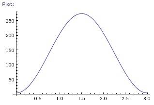

a) Here is a plot of the function we found for part b) over the first period:
https://www.physicsforums.com/attachments/861._xfImport
