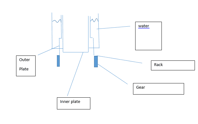

I'm trying to make two metal cylinders which will overlap to act as a valve for the outer cylinder to rotate around the other. I need to be able to stop water from the reservoir around the outer cylinder from leaking down between the plates and into the gap for the gear which will give the rotation. Is there a seal I can use either between the cylinders or for the gap left for the gear, which will allow rotation in the fit but won't let water through?

How would I hold it in place. I want the cylinders to overlap tightly, should I put the two cylinders on top of the seal, then fix it to them somehow?
Maybe I could make the gap between them bigger at the bottom to fit an O seal in, if its the case that this won't prevent the rotation.
Post a sketch of what you have . Show some basic dimensions .

I don't have any dimensions yet. Should I put an o ring in the gap between the outer and inner plate, then around the outer plate at the bottom, so water doesn't leek out?

There is not enough information in your sketch for me to really understand what you are doing .
If you would like to post a proper engineering drawing of your assembly then we can discuss this problem in more detail .
Couple of suggestions pro tem :
Ideally use a small diameter drive shaft for the moving drum and arrange two O rings spaced a short distance apart and with a drain point between the two rings .
In this sort of project it is often a good idea to arrange all the drive gear above the drums rather than below - that way you may only need minimal sealing or perhaps none at all .
