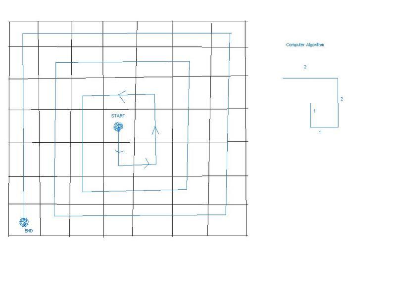

I am writing a programme which has to find specific cells with special properties. I don’t know where the cell are located by I have a pretty good idea so my programme can actually make qualified guesses. When I have guessed on a cell and it’s not the right one I have to check the cells lying beside it until I find the right cell. With help from a propagating sphere I have made a vector which solved the problem but I was wondering if one can make some kind of spiral algorithm. To explain what I mean I have made an example of an identical problem in two dimensions - this is seen in the drawing.
First I guess on some cell (start) and then I search all nearby cells one by one until I find the specific cell (end). To the right of the drawing you see the algorithm I could use, I just have to scale it the right way a loop.
Can I extent this idea to 3dimensions? If not, can you proof why? My guess is that the answer lies in graph theory – I just don’t know much about that..

You just re-discovered Ulam's Spiral.
You ought to be able to extend it to three dimensions.
For example, your starting point is the center of a 3x3 grid in two-dimensions.
It's also the center of a 3x3x3 cube in three-dimensions.
To do the next "ring", it is the center of a 5x5 grid or a 5x5x5 cube.
The next "ring" is a 7x7 grid or a 7x7x7 cube.
And so on.
It might be a bit tricky doing it in 3-D. Each time you increase your search space, say from a 3x3x3 cube to a 5x5x5 cube, you just want to crawl over the surface, no need to re-check the interior points (as would happen if you just did an Ulam's Spiral on each of the 5 layers).

I don't know of any examples in 3D, but it's not that hard to extend it since you already know how do do the spiral. (Well, I assume you know, based on your drawing. That is obviously what you want, but I don't know if you can actually implement it. If not I can give you tips.)
Anyway, assume the target cell is the reference (x,y,z coordinates are {0,0,0}).
Draw your spiral as before holding z constant at 0. Stop when you complete the 3x3 square. This square represents the middle slice of the cube. Upon completion, you are on one edge of the cube at coordinates {a,b,0}. Go down 1 in the z direction. You're at {a,b,-1}.
Draw the spiral again only in the reverse direction (spiraling inwards). When you stop, you'll be at {0,0,-1}, the center of the bottom face. Go up in the z direction by 2. Now you're at {0,0,1}, the center of the top face. Do the spiral again in the forward direction until you've made another 3x3 square. This completes all 3 layers of the 3x3x3 cube.
If doing the spiral in the reverse direction is too difficult, remember, you always know where the center of the top face of the cube is, it's always at {0,0,z}. If you're not too strict on it being continuous, you can always got the center and always draw your spirals in the forward direction.
This 3x3x3 cube would then be all the interior cells of the enclosing 5x5x5 cube. Again, the easiest way is simpy goto {0,0,z+1} and draw the spiral to a size of 5x5. Now, you're at a corner of the 5x5x5 cube, so go down 1 in the z direction. While on the middle levels, we don't need to draw the entire spiral (still need reverse, though) only 4 sides. When the fourth side is complete, instead of turning inwards, just go forwards 1 step. You'll be back at your starting point. Go down 1 in the z direction and repeat the 4 sides. Do this for all the middle layers.
Now, you're on the bottommost layer, at a corner of the cube {c,d,-2}. If you have the full reverse spiral algorithm simply execute that or recenter at {0,0,-2} and do it in the forwards direction.
From this point on, further 3D layers (7x7x7, 9x9x9, etc.) are simply repetions of the 5x5x5 algorithm.
It's a doddle. I'd give you an actual example, but my Turtle Graphics doesn't do 3D.
