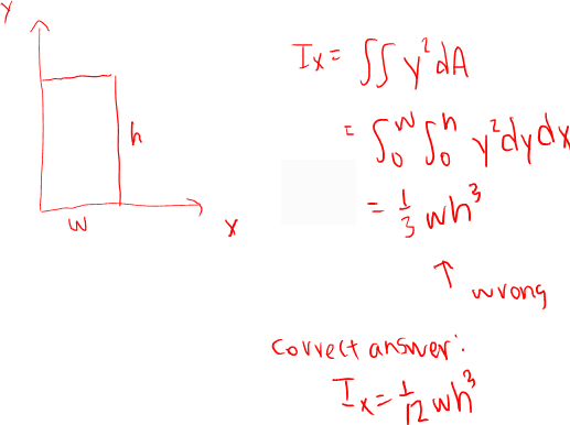

theBEAST Messages 361 Reaction score 0 Thread starter Dec 6, 2012 #1 Homework Statement Find the second moment of inertia of a rectangle. The Attempt at a Solution Anyone know why my answer is 4 times too big?

rock.freak667 Homework Helper Messages 6,221 Reaction score 31 Dec 6, 2012 #2 Your limits of integration imply that your axis of references is the x-axis (which is correct by the way). The "correct" answer you want is to get Ix about the centroidal axis. In which case your limits would be different.
