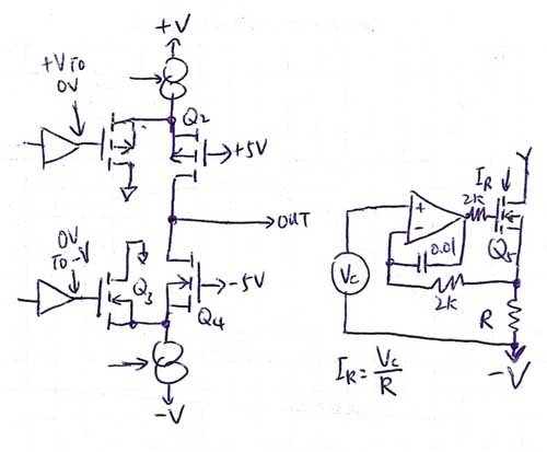

I cannot think of an easier way, this is what I have. This is a concept, not necessary a working circuit yet. This is a bipolar current pulse circuit that is programmable. This is not a small project, a lot more thinking has to be put into make it work. I am not going to guarantee this will work nor it's the best way, just an idea to start, anything more, I need to get pay!:smile::biggrin:
154613[/ATTACH]"]
Currents are generated by the two controlled current source. One suggestion of current source is shown using an opamp and Q5. This is to generate the -ve current source adjustable by the voltage across R as shown. You are going to have to generate the Vc that is reference to -V.
The pulse current is generated by differential pair made up of Q3 and Q4. Q3 is to steer the current. If the input of Q3 is 0V, Q4 will be turn off. But if input of Q3 is less than -5V, Q3 will be turned off and the Q4 will conduct the current from the current source below to the output. The +ve side works the same.
I use enhancement mode MOSFET instead of BJT so I don't have to worry about base current that cause inaccuracy. Also I don't have to worry about base-emitter diode voltage break down when switching. Use small signal MOSFET to avoid excess output capacitance. JFET might also work, you just have to work out the voltages, the driver and all.
If I can think of an easier way, I'll come back. But you are asking a lot and don't expect to have anything easy. This is going to be a project by itself, not exactly an ingenious little circuit with some fancy trick.
For 1uA resolution, you need a 12 bit DAC to get the accuracy even though the resolution is only 1/1000 or a 10 bit DAC. You can get away with 10 Bits data, just ground the 2LSB to guarantee accuracy.

Watch out the current created by negative feedback like your circuit. From my understanding, your current is done by a voltage source feeding back by sensing the voltage across R2B to create the current. It is only high impedance IF the loop gain of the circuit is high. When you run out of loop gain, the impedance at the output goes lower and lower. The only thing you can count on is the resistance of R2B. You are asking for 1MHz, that is not low for a closed loop feedback control system and you need to be careful about the poles and zeros and the speed of the opamp. Also, any closed loop feedback circuit has settling time concern. You need to get into control and stability estimation either by using Bode Plot or using LaPlace Transform. We have a resident expert here in the forum on closed loop feedback...Jim Hardy if he is around here today.
This kind of current sensing feedback type of circuit is commonly used in commercial current supply where it is a voltage supply with voltage controlled by the current from the output. These are not really current source when frequency goes up. That's the reason I mention you need to use high speed opamp to keep the loop gain high.
I don't know your application as you never described it. So when you asked for a current source, that's what I gave you. But if I know more about what you are driving, then I can start pushing the limit ( lower the output impedance) and make the circuit a lot more simple. You also need to specify the settling time requirement on top of the frequency. Or else, even if you can switch at 1MHz, the current level never settle down to have a stable value. Control system designer need to know this to design the closed loop. I do closed loop controlled system, but I am not an expert, I just get the job done, nothing to write home. I'll let expert like Jim Hardy and others to help you on your circuit.
In my design, the precision of the current is done by the circuit on the right side that don't require speed...as you can see the 0.01uF feedback cap I put as the dominant pole. The precision is by choosing the resistor R and the Vc source. The switching is done in open loop by the MOSFET or JFETs. those FETs don't have much gate current so what you draw from the source reflected exactly at the drain. This is precision by design and should have precision beyond 0.1% easily if choose quality parts.
BUT, before I make you worry too much, build the circuit and try it. It's easy to build.
I forgot to answer the Q3 and Q4. they form a differential pair. The current is supplied at the tail( the source of the two transistor where they connect together). So no matter how you switch, the current can only be the value set by the circuit on the right.
The way the differential pair works: The gate of Q4 is biased at -5V. say the Vgs to turn the FET on is +3V. So the source of Q4 should stay at -8V. Q3 serves to either steer the current away or not. If gate of Q3 is driven to 0V, the source of Q3 will follow and goes to -3V( remember Vgs is +3V). This will drive the source of Q4 to -3V. Therefore the Vgs of Q4 is -2V ( gate at -5V and source is driven to -3V by Q3). Q4 is off, all the current from the current source at the source of the FETs goes to the source of Q3 and nothing goes to the output of the circuit.
But if gate of Q3 goes to say -10V, the source of Q4 will hold the source of Q3 at -8V(-5V at gate +(-3V) or the Vgs). With this, the Vgs of Q3 is -2V. Q3 will be off. All the current from the current source at the bottom goes through Q4 and to the output. with this, you are sinking the exact current that is sunk by the current source at the bottom.
Since, gate current of FETs are much lower than the current source ( gate current are usually below 1nA or even in pA range). So whatever current the current source drawn, it reflects exactly at the output of the circuit. This way, I put the speed burden on the FETs and the precision current on the slow circuit composed of the opamp and R. The current source is operated in DC ( very slow speed), speed is from the FETs switching. With the right FETs, I think this can work to 25MHz limited by the switching circuit that drive the Q3.( you need RF FETs). And settle in nS. Remember, that's one requirement you need to ask yourself on top of 1MHz requirement. You can design one that can switch at 1MHz but cannot settle in 50nS...if the loop is under damp, it'll keep ringing even though it switches fast enough.

(1)How to control ONs and OFFs of Q1 and Q2 with proper timing if I want an adjustable duty factor? I preferred the DDS-based plan because it's easier to get adjustable duty factor.
If you want to pulse high, just drive the Q1, if you want to pulse low, drive Q3. If you need bipolar pulse, drive both together so it either source or sink current. That's what you were asking for...to be able to generate bipolar pulses, in fact, that's what making it hard and the circuit gets bigger!

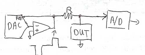

Here is what I have in mind. From my understanding, this should do what you want. The DAC should be bi-polar so 0V is 7FH for 8bit DAC, so you put value larger than 07FH to get positive pulse, or smaller than 07FH to get negative pulse. Any of the R/2R multiplying DAC that can settle at 10nS or so can do the job beautifully for you. You create the pulse by loading the DAC, nothing more. Then you read the divided voltage with a data acquisition module and calculate the resistance of the DUT in software.
154663[/ATTACH]"]
If you want really constant current. Use this circuit and control in the software. You know what you put into the DAC. Say you put in 5V. Say you then read back 3V. So you know you have 2V drop across your reference resistor R, agree?
If you know the value of your resistor R, and you know the voltage drop across it, you can control the current, right? So you really can simulate the constant current source by adjusting the DAC so you get constant voltage across the reference resistor R. You don't need to check every time you pulse, say you make the software check the current and do the calculation once every minute or so. Your aging drift is a slow process, check and calibrate the constant current ones per minute should be plenty. The rest of the time you just pulse the DAC. I think that sound very reasonable to take say 10mS to calibrate every minute and pulse at full speed the rest of the time.
The big different here is I put the burden onto the software and make the hardware very simple. Remember if this is a product and it is 24 channel, this cost money and my original circuit is not easy to implement. With this new approach, I put the burden on the software but this is a one time thing and don't cost anything in the product. The other true constant current source might need tweeking and all where this one pretty much guarantee by design if you choose the right DAC that has the accuracy and fast settling time. You still need some sort of DAC and A/D for any other approach, so you can see this new approach is really just an opamp and a resistor! What's not to like?
