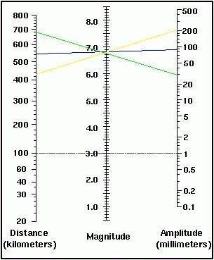

What is V/(m/sec)?
that's is Volts / metres / sec that is the "Velocity" type of sensor (magnet and coil arrangement
In the USA you will often see V/in/sec Volts /inch/sec... an example of a commercial geophone with a 4.5Hz resonant freq has a sensitivity of 0.810V/in/sec
for recording strong local events that would max out a velocity sensor ( unless sensitivity was turned way down) Accelerometers are used and the output from them is recorded as a percentage of g (gravity). so depending on the strength of the event you mite get a recording of 0.4g or maybe 1.2g etc etc. ground type, distance from event and other factors affect that measurement
it has no relationship to the Richter scale.
the Richter scale is a function of the measurement of the largest 0 (zero) line to peak movement of the ink pen on the seismogram and then using a nonogram when the distance is registered the magnitude is worked out (see image below). Richter developed the scale to deal with earthquakes in the local ~ 100km maximum distance, from the seismometer and for a specific type of seismometer. The term Richter scale has been severely misused by the media for many many years !
There are other more accurate ways used these days for evaluating the magnitude of an earthquake. The main one is the Moment magnitude which better represents the amount of energy released by the quake.
cheers

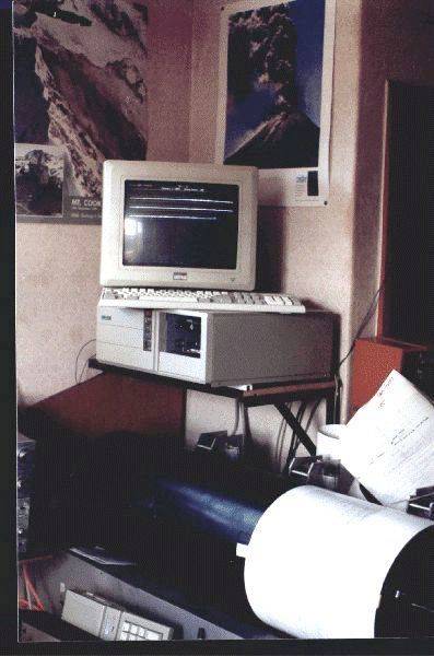

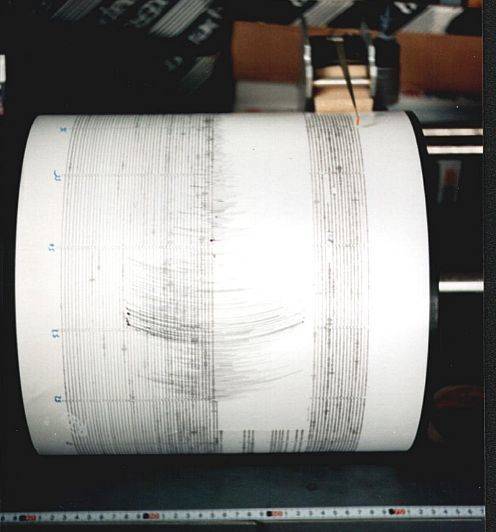

seismology is a passion of mine, having run my own seismic station from home since the early 1990's for the first few years it was just a ink pen/rotating drum recorder in the mid '90's I added a digital recorder.
There's a large number of us around the world doing amateur seismology.
the 2 pix below show
1... a close up of the drum with a large recorded event
2... the drum recorder and in the background the digital system
cheers
