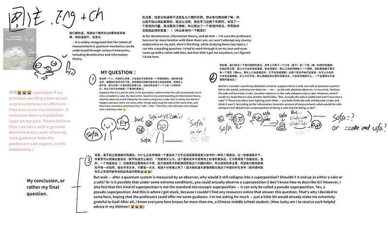

Hi everyone! I'm a 13-year-old student from China. My English might be rough, and my physics knowledge is just amateur obsession, so please be gentle! 😅
To reiterate: I'm a 13-year-old amateur, so my train of thought might have derailed a bit while writing this down. Please ignore any confusing parts! I promise the diagram on the left does a better job of explaining this "pseudo-superposition" mess than I do. Let's just look at the picture!
My core confusion is:
If all branches exist in the Multiverse, then the statement "MWI is correct" must also only be true in some branches, right? This feels self-referential.
Also, looking at the superposition of the cat (Sofa vs Cake), if there is no "conscious observer" (like a human) to ever check the box, does the superposition just stay forever? Would other universes even know what the "true" state is, or is reality just a consensus formed by redundant records?
I know I might be mixing up decoherence and information theory. Is there a paper or a term for this specific "self-reference" paradox in MWI?
Any help or even a good laugh is appreciated! Thanks!
”All branches exist” isn’t quite right, it’s better to say that there is a branch for every possible outcome, but violating the laws of physics is not a possible outcome. There will be a branch in which a subatomic particle has randomly decayed and there will be a branch in which the particle has not decayed, but there will not be a branch in which the particle turns into a bird and flies away. So if MWI is a correct law of physics it will be true in all branches.
The conscious observer is irrelevant. Branching happens with decoherence happens, and a cat or a camera or pretty much any macroscopic object like a measuring device is complex enough to decohere. So we have two branches, the cat knows which one it is in, and the only reason we don’t is that we haven’t looked.
Decoherence is one of the really important advances in our understanding since Schrodinger proposed the cat thought exper and since Everett came up with what we now call MWI. There’s a good layman-friendly explanation, Lindley’s book “Where does the weirdness go”, but I don’t know if there’s a Chinese translation.

A reply to my own post:First of all, thanks to everyone for the guidance! I've looked up some materials and successfully cleared up many of my earlier confusions. However, there's still one thing I haven't found an answer to, which is the core question in my hand-drawn diagram. Let me summarize it in text:
The core idea in the picture is:
Imagine a quantum system that can be in two states: "Cake" or "Sofa".
When measured, instead of collapsing to one, the observer himself enters a superposition.
This creates a "pseudo-superposition" where both results coexist coherently — but this feels self-referential because the observer is part of the system.
My main question is:
Is there a hidden paradox here that no one has fully addressed? Why doesn't this "pseudo-superposition" behave like the standard wave function collapse?
Sorry for the messy handwriting — I'm 13 and my drawing skills are worse than my English 😅
Because there is no wave function collapse in the MWI. So you should not expect the wave function in the MWI to behave like there is.

M4n90_L3m0n said:
it's about this "pseudo-superposition" idea in general, across interpretations.
Not all interpretations even have anything like what you appear to mean by "pseudo-superposition". You would need to be specific about which interpretation you are interested in talking about.
M4n90_L3m0n said:
is my "pseudo-superposition" just a clumsy way of describing relative states?
I couldn't say because I don't know exactly what you mean by "pseudo-superposition". It's not a recognized standard term in QM. You would need to write down some actual math and show in the math what you are referring to by that term, and I'm not sure you have enough knowledge of the math of QM to do that.
I would suggest taking the time to learn basic QM from a standard textbook before even trying to formulate such questions. If you are not comfortable with the basic math of QM and how it is used to make predictions, you are not really ready for any discussion of QM interpretations.
I would also caution you that discussion of personal theories is off limits here at PF. This from your OP, in particular, looks like an attempt at a personal theory:
