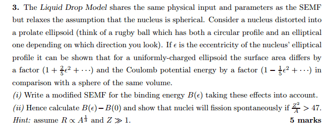

See attachment.
Only struggling with (ii).
So ultimately after doing everything, calculating B(ε)-B(0) & assuming z>>1 and z2/A > 47
I find that B(ε)-B(0) > 0.048ε2A2/3
I don't really see how this tells me if the nuclei will spontaneously fission or not, I still haven't used the assumption R is proportional to A1/3 though.
Any help please?
