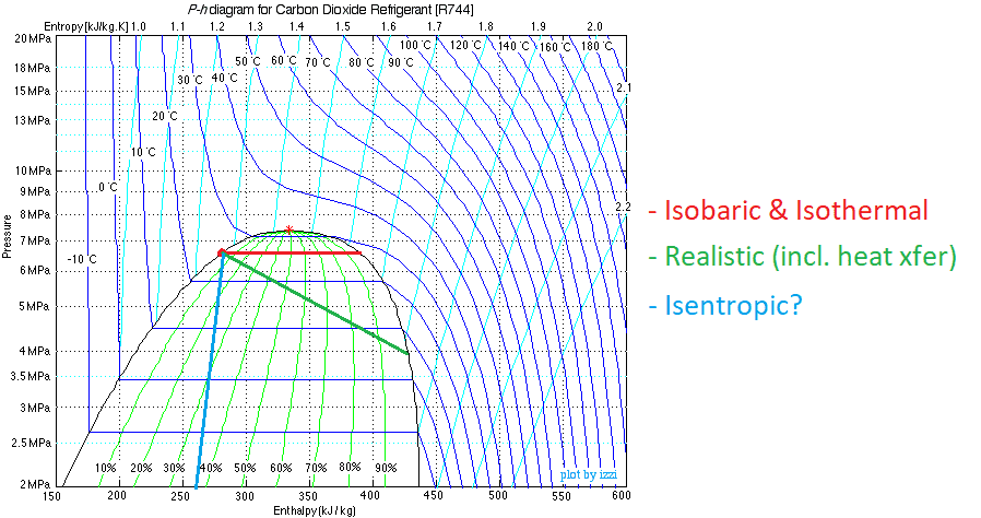

Moreover, how valid is it to treat this as an isentropic process? I would imagine that CO2 that's near-supercritical would diverge greatly from the ideal gas model, so would my results be even remotely close?
Why does a system need to behave like an ideal gas in order to execute an isentropic process? You need to get an enthalpy-pressure diagram for CO2 and examine it. I will be glad to answer questions about it.
I thought the very definition of "isentropic" assumed the gas behaved ideally. Then again, I'm still trying to work out how exactly that would affect me if all I'm doing is tracking entropy on a saturated gas table. Speaking of which...
Am I interpreting the isentropic process correctly? I thought I had my fill of PH diagrams when I took thermo 9 years ago! Kind of fun to be looking at them again.

  2. Looking at the gas table, I find that there are many possible temperatures for which my new specific volume could correspond to; the only difference being that each temperature would correspond to a different quality of the mixture.
  3. Assuming an isentropic process, I know that the new entropy will be equal to the initial entropy, which in turn means that there are many possible temperatures for which my entropy could correspond to; again the only difference being that each temperature corresponds to a different quality of the mixture.
  4. The task is to now figure out which temperature corresponds to the new specific volume and entropy which share the same quality. Probably some linear interpolations involved, maybe some iterations. Sounds like fun!
    Determine what temperature and quality correspond to the entropy and specific volume calculated above
  5. At this point, I'll have found my new temperature and, in turn, my new enthalpy. Now I would have to add some heat energy from the environment (obviously based on the temperature difference and with a heat transfer coefficient that I'll just have to fudge) and i'll arrive at a new enthalpy corresponding to some quality of the mixture.
    This part seems a little fishy, though. At each time step, I would essentially be adding my heat after the temperature has dropped as opposed to integrating over time. I'm going to have to think about how to better handle this. Moreover, I would need to have a function for Cp vs. Temp...

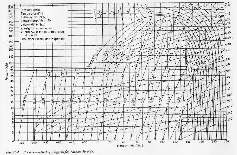

  1. This is all correct up to step 5. Very nice. But, in step 5, you need to determine the new internal energy per unit mass, not enthalpy. The mass that remains in the tank up to any time t is a closed system, and the first law requires use of the internal energy here.
Here is a better pressure-enthalpy diagram which includes constant entropy lines on it:
The lines labelled ...0.20, 0.24, 0.28,... are constant entropy lines. So, if your process involves no heat transfer from the environment, you follow one of these constant entropy lines down.
Now, if you have heat transfer from the environment, there are several considerations. There may be heat conduction through the wall and external heat transfer resistance. You may also need to consider the thermal inertia of the bottle. The material within the tank many also have conduction occurring, meaning that the temperature in the CO2 may not be spatially uniform. Before addressing any of this, you should first solve the problem without heat transfer from the environment. You can then make a determination a' postiori of whether heat transfer from the environment is going to be important.
This is extraordinarily insightful. I suppose I should have known, but I guess I was thinking "enthalpy" since I was dealing with pressure+volume as well as temperature, not just temperature alone. Also, I think I get how you're framing the problem now: Even though the total system is losing mass, by treating the mass that remains in the tank as closed you're essentially redefining the system boundary at every point in time. I get where you're going, but I think I just have to sit down and really think hard about it before I truly understand it.
There's a lot going on here, but I see what you're pointing to.
As an aside: It would be nice if there were higher definition versions of these charts--better yet in the form of scaleable vector graphics so users could zoom in indefinitely. Maybe I should make one...
The purpose of this p-H diagram was just to give you an idea of what the isentropic lines look like, and a crude tool for getting a quick answer to your problem. For your detailed calculations, however, you can get what you need from your saturated CO2 tables.

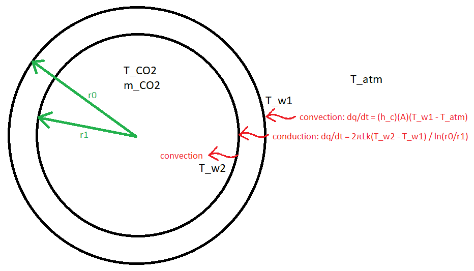

I got it working! I realized later on that by removing some mass from the system, I was effectively forcing a change of the specific volume. All I had to do was calculate the new specific volume, and assuming constant entropy, I derived a relationship between those properties and temperature by equating the quality as determined by specific volume with the quality as determined by entropy (I needed to program a look-up table for the saturated liquid & gas states as they vary by temperature). 'lo and behold, I was able to determine the temperature and quality of the two-phase mixture at any given point of source depletion, and it followed right along the constant entropy lines on the P-H diagram.
I also realized that up to this point the entire exercise has been independent of time. All I made was a script that would find the temperature given a new specific volume and assuming constant entropy. Now that I have the first part working, I'll want to include heat x-fer from the environment, but that WILL have to have a time component to it (and it will have to be non-isentropic).
For simplicity, I will ignore gravity and radiation, and I will assume constant heat transfer coefficients. I'm still having trouble conceptualizing exactly how to formulate the equations for this model, though. At every instance in time, the temperature drops due to expansion, but it won't drop as much as the isentropic case due to heat transfer. So when formulating this, do I assume an isentropic process at every time step, then "correct" the resultant temperature by introducing some amount of heat transfer from the surroundings? Or is there are more elegant, mathematical way that models it with a series of differential equations?
I've thrown together a simple diagram of the setup. I know the initial conditions, and I know the geometry of the bottle, and I'm assuming some of the constants (for the time being). Now that we're introducing heat transfer, this is a non-isentropic case and I (assume) I'll have to include the enthalpy of the gas, but I'm struggling to figure out where that comes in.

Before you decide how to obtain a numerical solution, you must first decide upon the model and the model equations that you are going to be solving. To do this, you need to reconsider the physics of the problem.
1. Up to now, you have been assuming that there is no heat transfer between the gas and its surroundings, which consist of the cylinder itself and well as the environment surrounding the cylinder. So, even though the gas is cooling, you have assumed that the cylinder remains at the original temperature. You have neglected the cooling of the cylinder (which has thermal inertia) and any heat exchange taking place between the cylinder and the gas. You need to make a determination of whether you think this is a good approximation. To do this, you should compare the mass times heat capacity of the cylinder with the mass times heat capacity of the gas. If both the gas and the cylinder had the same temperature history during the change (say, with very rapid heat transfer between the cylinder and the gas), how would this change things.
2. Even if there were still no heat transfer with the surrounding environment, if the thermal inertia of the cylinder were important, it might also be necessary to treat the cylinder as having a temperature profile which varies with both radial position and time. So you would have to solve the transient heat conduction equation within the cylinder metal. This needs to be considered.
3. With heat transfer present between the cylinder and the gas, you may also have temperature gradients and heat transfer resistance within the gas, so that the gas is not uniform in temperature, at least near the boundary. Natural convection within the gas might also be a consideration.
So, in short, modeling the system in terms of an overall heat transfer coefficient between the surroundings and the gas (as you have been considering up to now in your post) may not give the accuracy of the answer that you desire, and might need to be reconsidered in detail, in light of items 1-3 above. Depending on what determination you make regarding the validity of assumptions and approximations, an appropriate model can be formulated. Certainly, for the model proposed in your previous post (with its inherent approximations), the formulation and solution are straightforward.

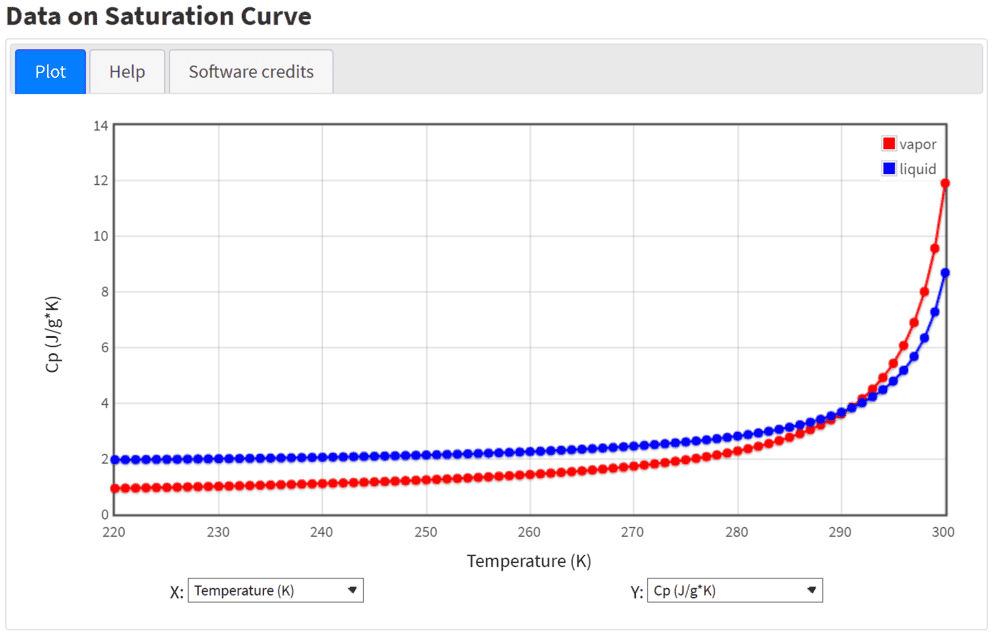

This makes sense conceptually, and running the numbers I find that in the initial state, 250g of saturated liquid CO2 at room temp has ~3x the heat capacity as the surrounding 530g Aluminum container, but since Cp for saturated CO2 is highly dependent on temperature, and since CO2 is slowly depleting from the system, this ratio will swap at some point. Towards the end, the heat capacity of the surrounding Aluminum container will dominate. It's hard to say exactly when without a working time-dependent model, but at the very least I think it's safe to say we can't ignore the surrounding structure.
Mass (Al): 255g
Cp (Al): 0.91 kJ/kg-K
Mass (CO2 init): 531g
Cp (Saturated CO2): Varies based on the graph below
242711
