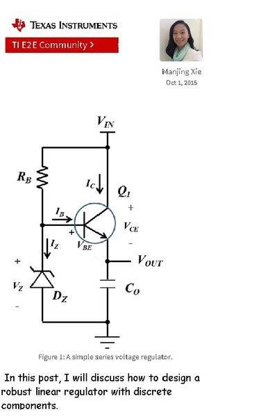

I would like to make a series pass linear regulator using discrete components.
For a first design with discrete components , just grab a nice zener diode and tack an emitter follower behind it.
Here's a far simpler "How To " from TI : https://e2e.ti.com/blogs_/b/powerho...ies-linear-regulator-with-discrete-components
