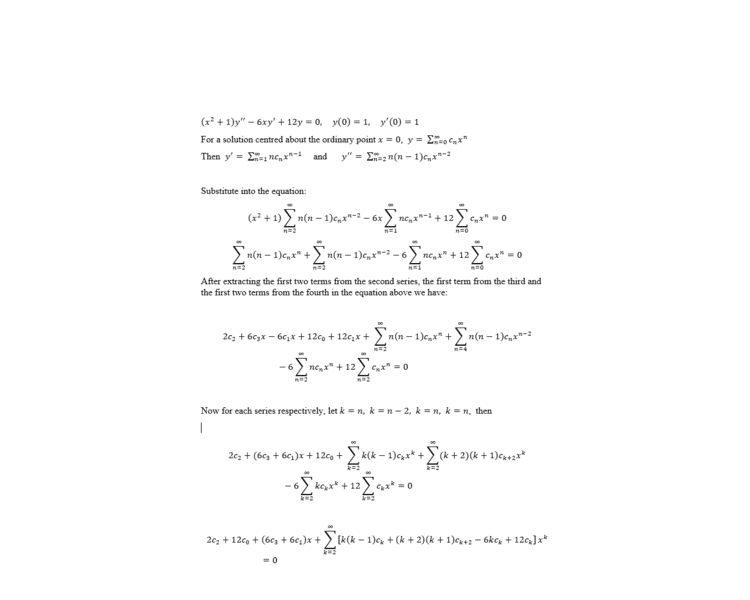

Use the power series method to solve the initial value problem:
##(x^2 +1)y'' - 6xy' + 12y = 0, y(0) = 1, y'(0) = 1##
Handwritten-style typeset derivation of a power series solution to (x^2 + 1)y'' - 6xy' + 12y = 0 with y(0) = 1, y'(0) = 1, showing substitution of series and collected coefficient sums with index shifts k = n, k = n-2.
The trouble here is that after the process above I end up with ##c_{k+2} = - \frac{(k-3)(k-4)}{(k+2)(k+1)}c_k##, giving nothing but zeroes for ##k = 3## onward, which cannot be correct. Where have I gone wrong here?

Second order ODE (x^2 + 1)y'' - 6xy' + 12y = 0 with initial conditions y(0) = 1 and y'(0) = 0.
For a solution centred about the ordinary point
Power series expression y = sum from n = 0 to infinity of c_n x^n, written as a summation with coefficients c_n.
Then
Handwritten expression y' equals the sum from n = 1 to infinity of n c_n x^(n-1), the derivative of a power series in x.
and
Equation y'' = sum from n=2 to infinity of n(n-1)c_n x^(n-2), the second derivative of a power series with respect to x.
Substitute into the equation:
Equation: (x^2 + 1) times sum from n=2 to infinity of n(n-1)c_n x^(n-2), minus 6x times sum from n=1 to infinity of n c_n x^(n-1), plus 12 times sum from n=0 to infinity of c_n x^n, equals 0.

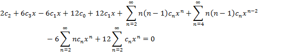

Handwritten-style equation: sum from n=2 to infinity of n(n-1)c_n x^n, plus sum from n=2 to infinity of n(n-1)c_n x^(n-2), minus 6 times sum from n=1 to infinity of n c_n x^n, plus 12 times sum from n=0 to infinity of c_n x^n, equals 0.
After extracting the first two terms from the second series, the first term from the third and the first two terms from the fourth in the equation above we have:
Handwritten-style equation showing collected power series terms: 2c2 + 6c3x - 6c1x + 12c0 + 12c1x + sum from n=2 to infinity of n(n-1)c_n x^n + sum from n=4 to infinity of n(n-1)c_n x^(n-2) - 6 sum from n=2 to infinity of n c_n x^n + 12 sum from n=2 to infinity of c_n x^n = 0.
Now for each series respectively, let
Handwritten or typeset conditions reading k = n, k = n − 2, k = n, k = n, giving index relations used when shifting summation indices in a series solution.
, then

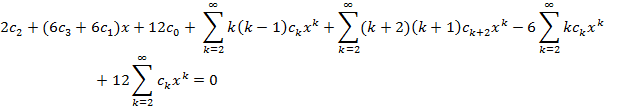

Equation combining power series sums: 2c2 + (6c3 + 6c1)x + 12c0 + sum from k=2 to infinity of k(k-1)c_k x^k + sum from k=2 to infinity of (k+2)(k+1)c_(k+2) x^k - 6 sum from k=2 to infinity of k c_k x^k + 12 sum from k=2 to infinity of c_k x^k = 0.
Recurrence equation from a power series substitution: 2c_2 + 12c_0 + (6c_3 + 6c_1)x + sum from k=2 to infinity of [k(k-1)c_k + (k+2)(k+1)c_{k+2} - 6kc_k + 12c_k] x^k = 0.
Then
Two recurrence relations written in plain text: c_2 = -6c_0, and c_3 = -c_1.
And
Recurrence relation c_{k+2} = (k^2 - 7k + 12)/((k+2)(k+1)) c_k, rewritten as (k-3)(k-4)/((k+2)(k+1)) c_k.

So your conclusion with ##y(0) = c_0 = 1## and ##y'(0) = c_1 = 1## would be that ##c_2 = -6##, ##c_3 = -1##, and ##c_4 = 1##, i.e.,
y(x) = 1 + x - 6x^2 - x^3 + x^4.
Why do you think that is wrong?
Also, there is no reason for separating the equations for ##n = 2## and ##n = 3##. They are the same functional expression as you can add zeros to the sums without affecting them, for example
\sum_{n=2}^\infty c_n n(n-1) x^n = \sum_{n=0}^\infty c_n n(n-1) x^n
since ##n(n-1) = 0## for both ##n = 0## and ##n = 1##.
Actually, it appears to be correct. I thought it a bit odd that every term after that is zero. A bit of a sneaky question, I guess.
A series expansion that terminates is still a series expansion ... :rolleyes:
