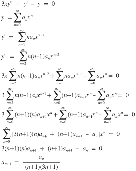

Use the power series to solve the following differential equations, state the first four terms of the two independent solutions.
3xy'' + y' - y = 0
The power series.
How do I get two independent solutions out of this? All of my coefficients will depend on the first a...?
Your differential equation is singular at x=0. There are two solutions but one of them is singular at x=0. Your power series solution will only pick up the nonsingular one.
Ah ok, so the problem is screwed up from the beginning, thanks :)
Search for the form of the series solution near a regular singular point.
