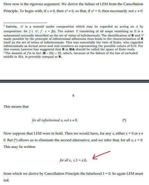

1.What does "ε.1" and "ε.0" mean in this proof? (photo1) (https://publish.uwo.ca/~jbell/basic.pdf , page 5-6)

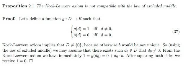

2. For what purpose do we use Kock-Lawvere axiom when we deal with law of excluded middle? (photo2) (https://www.fuw.edu.pl/~kostecki/sdg.pdf , page 21)
This is standard notation (although perhaps not typeset very well). ## \varepsilon \cdot 1 ## means ε multiplied by 1. Photo 1 is part of a proof that the law of the excluded middle (LEM) does not hold in SIA.
I don't understand what you are asking. In photo 2 the author uses the Kock-Lawvere Axiom and LEM to derive a statement that is a contradiction, again proving that LEM does not hold in SIA.
