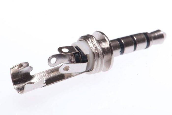

I have a 3 conductor wire that are all wrapped in a foil shield with wire conductor, for a total of 4 wires.
I am connecting the 3 inside wires to audio left, right, and ground. This is an unbalanced setup, right?
Where/how do I connect the shielding?
Do I connect both sides (i think no)? Which side? To where?
My choices for where to connect the shield: audio ground, chassis, nothing
I would like to avoid all ground loops and noise.

I'd advise OP to rely on his equipment being designed well
and simply connect his three signal wires to tip & rings, shield to sleeve.
...being sure to slide the cover up the cable before soldering the wires in place.
