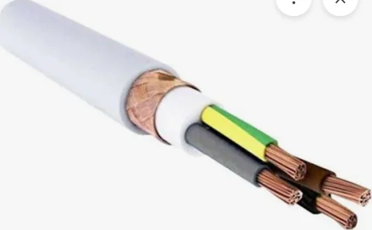

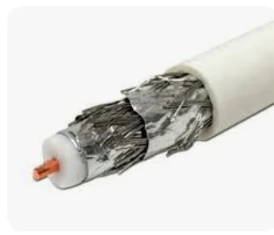

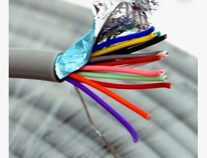

The issue is, that different cables/shieldings can have different purpose and so simplification might make the question miss the mark entirely.
This:
or this:
or this:
...are meant to be very different.
This: View attachment 366264 or this: View attachment 366265or this: View attachment 366266
I think all of those cables can be used to send a current in one end, and you'll get it out at the other end. Sure they have different "advanced" properties - like wire cross section area, internal interference, how much current they handle, how much voltage you can apply before you may experience internal short, how easy they are to bend, and so on - but the basic properties are quite similar - they are all copper wrapped in none-conductive material. You can apply a voltage at one end, and measure the voltage at the other end. And if you send current through, the current you measure at one end will be identical to the current you measure at the other end, they all have a wire resistance. The value of that wire resistance is different, but they all have a resistance of some value.
And for the multi-wire cables - if you connect two of the wires together at both ends, you will find that the resistance from one end to the other end has become 50% of what you found with only one wire in use. The two wires connected together at both ends, will mostly behave like one wire with the double cross section area.
Also the coax - if you connect the inner wire with the outer wire, the cable will behave mostly like a single wire with a cross section equal to the sum of the two wires cross section. Although, electrons may prefer to travel in the outer wire because of the skin effect.
