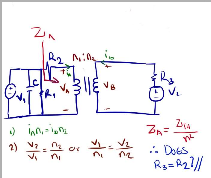

Hello, i just a have a doubt regarding the transformer impedance, my professor told me that the impedance before the primary coil should match the net impedance seen by the secondary coil, is that correct, i am not so sure about it.
I would really appreciate it if you can help me with it. Thank you in advance.
N/A
I tried to explain it by picture, if that can help you aid what my question is:
Hand-drawn circuit schematic with a transformer between a primary side containing R2, a coil, capacitor C, R1 and source V1, and a secondary side with R3 and source V2. Annotations show ZA = ZTH / n^2, the turns relation i_A n1 = i_B n2, voltage ratio equations, and the conclusion R3 = R2 written in blue.
It is not always the same. For analysis, it is simpler to refer the impedances to one side and then start the analysis.
