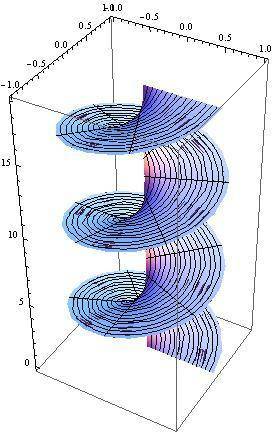

I think learning many concepts involving multi-valuedness should begin with the complex logarithmic function and it's geometry. So understand that first: it's imaginary part consists of an infinitely-folded sheet which wraps around itself like a twisted helix shown below.
For now, just take [itex]n=2[/itex] so that if [itex](q)^2=z[/itex] then
[tex] \begin{align}<br /> q&=z^{1/2}\\<br /> &=e^{1/2\log(z)}\\<br /> &=\exp\{1/2(\ln|z|+i(\Theta+2n\pi))\}<br /> \end{align}[/tex]
so that if we are to have a single-valued function [itex]myq=e^{1/2\log(z)}[/itex], then we must necessarily excise a single-valued part of the log sheet. The largest contiguous section we can remove before it begins to overlap itself again would be an arc-section slightly less than [itex]2\pi[/itex] for example, a part defined as:
[tex]\text{mylog(z)}=\ln|z|+i\Theta,\quad 0\leq\Theta< 2\pi[/tex]
and then write as the single-valued branch of [itex]q[/itex]:
[tex]myq=e^{1/2\;\text{mylog(z)}}[/tex]
or something similar to that using a different starting and ending region for [itex]\Theta[/itex]. That section of the [itex]\log[/itex] sheet we remove is called a "branch" of the function and where we make the cut is called the branch cut. But since the imaginary part of [itex]\text{mylog(z)}[/itex] is equal to [itex]\Theta[/itex], then the function [itex]\text{Im(mylog)}=v(r,\Theta)=\Theta,\quad 0\leq\Theta<2\pi[/itex] or rather this surface in 3D space, is not continuous (or contiguous) along the ray [itex]\theta=0[/itex]. You should go our of your way to draw this function and really see visually why it's not continuous; rather, there is a sharp cliff rising a height of [itex]2\pi[/itex] and so [itex]\text{mylog}[/itex] is not continuous there and so too must be [itex]myq[/itex]. Same dif with the other n's.

Ok this mostly makes sense, especially when you say "there is a sharp cliff rising a height of 2π" as that is how I have always envisioned it.
One thing I can't figure out is that I thought this problem of multi-valuedness with period 2π was a problem for all complex functions, what is so special about my q_n functions? I mean I understand that for example the square-root function is already a multi-valued function, even if we just consider it as a function from ℝ to ℝ so I guess in my brain I have the root functions which seem intrinsically multi-valued, where one must specify which root one wants produced for each z in the domain, and then on the other hand one has the problem of multi-valuedness for all complex functions because of the period 2π thing, and this somehow feels more extrinsic, sort of forced on the function by the nature of the complex plane.
The way I see the q_n function is that it is some function that takes every z to exactly one of its nth roots, you just don't know which. And thinking of it like that it is not at all obvious to me why such a function would have problems being continuous unless ALL functions in the complex plane would have a similar problem being continuous, which brings me back to my feeling that this branch-cut issue is somehow being forced on the function by the nature of the complex plane, and is not really a problem with the function itself.
So you're saying that helicoid you attached has its x and y coordinates as the real and imaginary input and then just outputs the angle and that's the z coordinate. That makes sense. I mean I understand conceptually most of what you're saying but I still can't figure out what makes q_n so special in not being continuous.

then the imaginary component of log(z) is [itex]u(r,\theta)=\theta[/itex]. Ok, if you plot [itex]u(r,\theta)[/itex]as a function of the two variables r and theta, you'll get the helicoid.
