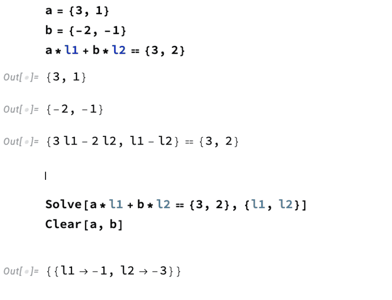

This is the tutorial we received on how to solve linear systems with Mathematica:
Mathematica notebook showing a = {3, 1}, b = {-2, -1}, and the equation a*l1 + b*l2 == {3, 2} with outputs, then Solve[a*l1 + b*l2 == {3, 2}, {l1, l2}] returning {{l1 -> -1, l2 -> -3}}.

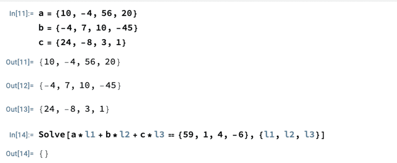

I then tried the whole thing for the task, but unfortunately Mathematica doesn't give me any values, just an empty output. Unfortunately, I do not know what I did wrong, because I followed the instructions 1-to-1.
Mathematica session: a, b, c defined as lists {10, -4, 56, 20}, {-4, 7, 10, -45}, {24, -8, 3, 1}, then Solve[a*l1 + b*l2 + c*l3 == {59, 1, 4, -6}, {l1, l2, l3}] returns {}.
You have four equations and three unknowns. Are you sure that there is a solution?
You could remove one equation and see if the matrix has a non-zero determinant. If so, solve those equations and see if it also solves the equation that you removed.
There isn't a solution. Mathematica is correctly identifying the fact that there is no solution. You can also use Reduce instead of Solve, and the result of Reduce is False, indicating that the equation is inconsistent.

Thanks FactChecker, Dale, pasmith and BvU for your help 👍👍👍👍 I just got the message from my lecturer that he chose the vector d incorrectly, which is why the vectors are so linearly independent and why the equation has no solution 🙃
