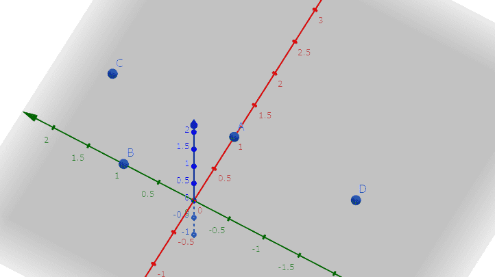

That's one possibility. There's another. There are two different positions in the plane where there's a 60 degree angle between ##\vec a## and ##\vec c##. Draw a picture.
##\vec a=(1,0,0)## ##\vec b=(0,1,0)## ##\vec c=(1,1,0)## , i choose this point . and clearly c is in span of a and b, can you give me more hint?
What is the magnitude of ##\vec c##? What can be the components then?

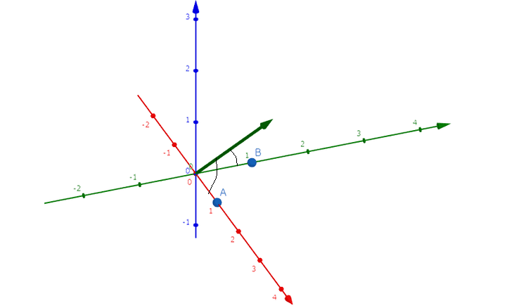

##\vec
can you point how can i see the angle here?

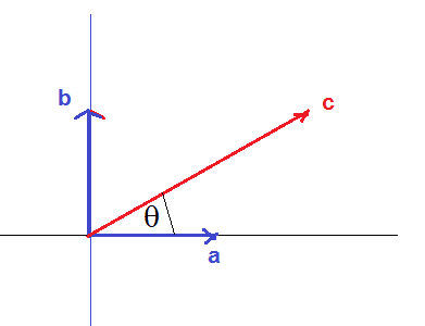

Two vectors of the three are independent, and the third can be combined from the two others. You can write vector c as linear combination of a and b vectors, and find the coefficients from the given data.

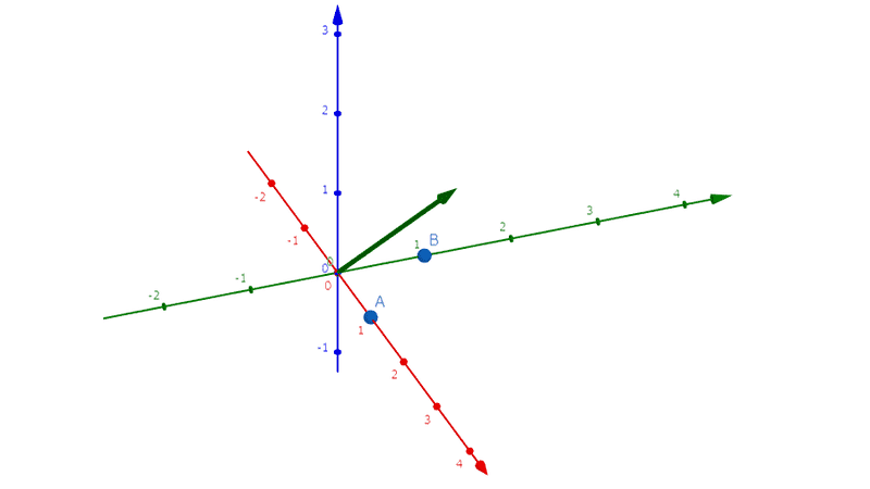

yes but is the picture that i drew right? how can i find the angle between them?
##\vecView attachment 226262
You define angles between two vectors, a and c, b and c. But you draw the vector c out of the plane spread by a and b, as if it had a component perpendicular to both a and b, so independent from them. Remember, they are dependent in 3 dimension. That means they are in one plane.

There are two angles here, between a and c and between b and c. Are the vectors in the drawing dependent?
i think here i was wrong, the three vector are independent to each other in my drawing because they are not in same plane right?
so what coordinate should i choose for c? is ##c=(1,1, \sqrt2)## wrong?
