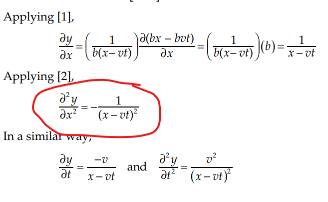

For this problem,
Printed problem text: Show that the wave function y = ln [b(x − vt)] is a solution to Equation 16.27, where b is a constant.
Where equation 16.27 is the wave equation.
The solution is
Handwritten-style math derivation with partial derivatives of y = ln(bx - bvt): first derivative 1/(b(x - vt)) times b gives 1/(x - vt); circled second derivative d2y/dx2 = -1/(x - vt)^2; then dy/dt = -v/(x - vt) and d2y/dt2 = v^2/(x - vt)^2.

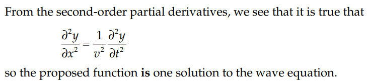

Typeset text: From the second-order partial derivatives, we see that it is true that ∂²y/∂x² = (1/v²)·∂²y/∂t², so the proposed function is one solution to the wave equation.
I don't understand how they got the second partial derivative of ##y## with respect to
##x## circled in red.
I thought it would be ##1## since ##v## and ##t## are constants
Many thanks!

You are likely over-thinking this. Use the chain rule.
Big hint:
##\dfrac{ \partial }{ \partial x} \dfrac{1}{x - vt} \rightarrow \dfrac{ \partial }{ \partial u } \dfrac{1}{u} \cdot \dfrac{ \partial u}{ \partial x}##
What would you use for u?
-Dan

Thank you for your reply @topsquark !
##u = x- vt##
Sorry do you please know why we need to use the chain rule?
Thank you!
Because that is what tells you how to differentiate ##\frac 1{x-vt}## wrt ##x##. First, you differentiate it wrt ##x-vt##, 'cos that's easy, then you multiply by the derivative of ##x-vt## wrt ##x##.
Perhaps you "misspoke" here? ##t## is the time variable, as you must be aware?

Yeah I agree that ##t## is a time variable, however, I thought I was meant to treat it has a constant along with ##v## since we are partially differentiating ##y## with respect to ##x##.
Many thanks!
Ah, okay. Yes, for the purposes of doing partial derivatives w.r.t. other variables, that's right.

I guess one way of thinking about it is thinking that ##x -vt## is in brackets to the power of 1 since you must always use chain rule for brackets. I guess we also have to use chain rule here because we can't bring the x up because it is with the other terms.

$$\frac d {dx}\bigg (\frac 1 {f(x)}\bigg ) = -\frac {f'(x)}{(f(x))^2}$$

You don't need the chain rule for
$$\frac{d}{dx}(x^2+x).$$ Parentheses, brackets, etc. don't automatically mean the chain rule.
Based on what you initially wrote, you seemed to be thinking
$$\frac{\partial}{\partial x} \frac{1}{x-vt} =\frac{1}{\frac{\partial}{\partial x}{(x-vt)}} = \frac 11 = 1.$$ I hope you see that the first equality is wrong. That's not how differentiation works.
Because you're differentiating a quotient, you could use the quotient rule and not use the chain rule. Most people, however, would use the chain rule because the numerator is a constant. It might help to rewrite the problem as
$$\frac{\partial}{\partial x} (x-vt)^{-1}.$$
Right.
