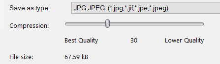

I submitted a picture(.jpeg), was told it's too big. How to shrink it?
Hi,
So I submitted a picture , a .jpeg file, and, at 5.7 mb, I was told it's too large, I need to shrink it. Just how do I do that? I doubt I can zip it. Should I save it in a paint program? Any other idea?
Edit: I guess it comes down to increasing the compression ratio. Just if it's simple, does anyone know how to increase the compression ratio?

No, paint programs are for creating drawings. Most image viewers are able to resize and compress images e.g. Windows Photos. Right-click on the jpg file and see what you have installed.

Exactly. Find a compression app and use 30% compression instead of 100%

Yeah, first reduce the dimensions. Not much point in it being bigger than it will be onscreen. If the file size is still too large, then increase the compression.

I think most apps can do both at the same time. Crop then save and the save can be set to whatever compression you want.
Yes, instead of saving it as a, say, 1900 x 620 pixels, save it as a , say, 640x320.

Cropping means making smaller by cutting bits off; you may not want to do that. Resizing means making smaller by decreasing resolution.

I recently had 15 photos that were each about 3-5 MB. I brought each one into GIMP (a free download, which is a popular photo editor) and clicked "File" ->"Export as" ->"Export" -> change name if you don't want to overwrite -> set quality at 60 -> "Export".
It reduced that size greatly and I could not visually see the difference on my monitor. For instance, it turned a 3.75 MB file into a 936 KB file.

IrfanView is a nice program that can resize images. You can choose % of original image, which will decrease both size and dimensions.

First, resize the photo(s), i.e. change the pixel dimensions, to suit their intended use. Then set the JPEG quality level (compression) to lowest value that will give an acceptable appearance for the intended use.
My iPhone XR (which is now a 5 year old model) produces 4032x3024 pixel images, which are way... too... big for on-screen use, even on my iMac with a 27-inch display. Resizing them in Photoshop by factors of 1/2 and 1/4 gives the following file sizes, all at maximum JPEG quality, which Photoshop calls level 10:
original 4032x3024: 4.2MB
1/2 size 2016x1512: 1.5MB
1/4 size 1008x756: 585KB
I can reduce the file size further by reducing the JPEG quality. At high quality (level 8):
4032x3024: 2.5MB
2016x1512: 1.0MB
1008x756: 398KB
And at medium quality (level 5):
4032x3024: 1.6MB
2016x1512: 704KB
1008x756: 294KB
