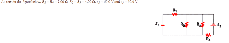

http://imgur.com/PJVmXEc
Calculate the power delivered to (or dissipated by) R1
V=IR
P=I^2R
I attempted to calculate the equivalence resistance by doing... 2+(2^-1+4^-1+4^-1)^-1 = and I get 3.
I later calculate a current of 36.67Amps, and a power of 2688 watts. What did I do wrong.
then I tr
I also tried... 60-2I2-4I2=0, 60-2I1-4I3=0, 110 -2I4-2I1=0

This cannot be analyzed as a parallel/series circuit. That sort of method can only be used to replace R2 & R3 by considering them to be in parallel (for this circuit.)
Use Kirchhoff's Laws for the complete analysis.
