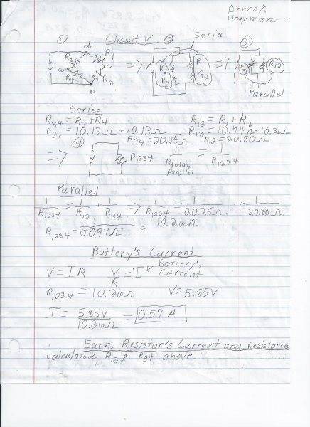

I attempted to the voltages and currents of each resistor but do not understand about breaking them down into parallel and series. Like for circuit 5, I broke them into series and parallel. Then how do I calculate the current of each resistor? Do I calculate the current, resistance and go back and forth? Also, voltage drops confuse me. I attached the work I have and what I attempted to do.
If someone could check it over to make sure I do it correctly that would be great and explain the process that would be amazing! It is due very soon and I don't know what to do.

Scan 7 showed Circuit 5. I broke it down because R3 and R4 were in series as well as R1 and R2. Then R34 and R12 were in parallel. This created R1234. I calculated the equivalent reistance of R1234 first by using the series equation and adding the resistances together. Then I did 1/R1234 to calculate the equivalent resistance. For the battery's current I used the voltage divided by the equivalent resistance. Here's where I don't understnad R1, R2, R3 and R4. how do I calculate the restiantces and currents. I12=V12/R12. I got I12=I1=I2
Then for V1=I1R1. Then I calculated V2 from the current I12xR2. Same with V3. Could someone check my work?

Your work looks correct.
I think you are just confused about what you are supposed to do and not how to do it.
Your physics and calculations are fine.
