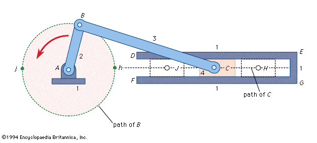

Hi, so in class we are suppose to make a motor kinda like the one in this video with copper wire.
That part shouldn't be hard but I also need to make it move something (like a coin), I'm not really to sure how to make that happen. Does anyone have any insight on how I can get the rotational motion of the coil to move something?
I was thinking about adding a wheel to one of the open ends of the wire and attaching string and a coin to it so when it moves with the motor it lures the coin in like a fishing rod, but I'm sure there are better ways of doing it, any idea?
Any help would be appreciated, thanks. c :
Yes that's one way to do it converting the spinning motion into a pulling motion.
Another idea would be a wheel with a straw attached via one nail so as the wheel spins the straw moves back and forth like a piston so you could push the coin.
I can't really visualize what you mean, mind rephrasing it for me please.
Like this arrangement:
Kinematic diagram of a slider-crank mechanism: crank 2 pivoting at A on fixed link 1 with a circular path of B shown, connecting rod 3 linking B to slider 4 that moves horizontally in a channel, with the path of C indicated.
