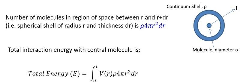

Please see below.
I'm probably being really stupid here but how can the number of molecules equal
If we integrate we get a volume multiplied by density, how can that equal a number of particles?
##\rho## is not a mass density (kg/m3) but a particle density (number of particles/m3).
Of course! many thanks for clearing this up.
