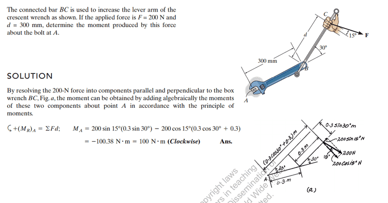

I understand 90% of the problem and how to do it, I just can't wrap my head around how they managed to get 0.3sin30 for that one side in the problem.

Figured it out, thanks :P
