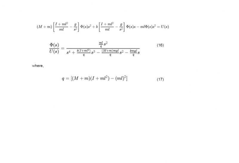

Simplification Question: Steps from First Line to Second Line

Does anyone know what was done to go from the first line to the second?
I don't know what sequence of steps they did after the angle was factored.
I think both sides were then multiplied by \frac{mls^2}{(M+m)(I+ml^2)} or something?
From the original equation get a common denominator, mls2. for all terms. collect terms in s4,s3,s2 and s.
write Φ/U divide the numerator and denominator by the coefficient of the s4 term which is q. DA DA.
