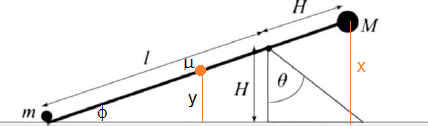

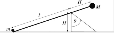

The trebuchet is a siege engine that was employed in the Middle Ages to smash castle walls or to lob projectiles over them. A simplified version of a trebuchet is shown in the following figure. A heavy weight of mass M falls under gravity, and thereby lifts a lighter weight of mass m. The motion of the mass M is blocked as shown in the figure, which launches the lighter mass m; the blockade forms an angle θ with the vertical. The mass of the blockade is much larger than all other masses. The shorter arm of the trebuchet is of length H , whereas the longer arm is of length l; the whole beam (both arms) are of mass µ.
conservation of energy
ok i did the solution but i got a super complicated expression for omega i will is it supposed to be that way? and is it possible to get a numerical value for omega from the given information? i have just described my solution in words if you want my actual equations i would gladly post thanks
x y a b are heights above ground
I moment of inertia
v translational velocity of masses
Ei = Ef
Mgx + μ(L+H)gy = Mga + μ(L+H)gb + 1/2 I ω2 + 1/2 Mv2 + 1/2 m v2
y = (L+H)/2 sin tan-1(H/L)
x = (L+H) sin tan-1(H/L)
a = H(1 - cosθ)
b = H + (L-H)/2 cosθ
I = 1/12 μ(L+H)3 + μ(L+H)(L-H)2/4
v of M : ω* H
v of m : ω * L
is this correct?

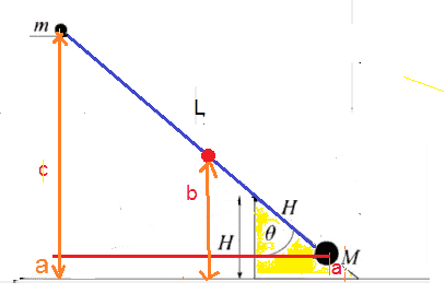

The heights of what and when are x, y, a, b?
I is moment of inertia about what axis?
v is linear velocity, but it is different for m and M. Use different symbol for them.
@ehild
sorry for the ambiguity was in a rush that day let me explain myself
x is the initial height of mass M above the ground
y is the initial height of centre of mass of rod above the ground
a is the final height of mass M above the ground
b is the final height of centre of mass of rod above the ground
new variable i forgot to include
c is the final height of mass m above the ground
I is the moment of inertia about where the rod is pivotted i had used the parallel axis theorem
vm = ωL
vM = ωH
am i right now?

H/L=sin(φ), x=(L+H)sin(φ) and y=sin(φ)(L+H)/2. What are the initial and final potential energies?
Initial state:
Final state

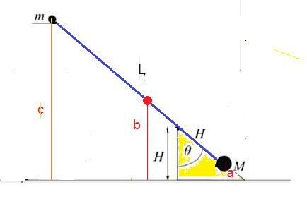

vishnu 73 said:
is this correct ?
What is your zero of potential energy? If it is the ground, then the initial PE is correct. The final PE is not. You need to add distance a (see the diagram posted by @ehild) to all the final vertical distances.

vishnu 73 said:
@kuruman
yes my zero potential energy is ground
but i don't see what height i need to add as far as i know i have accounted for all the heights
please point out to me
See figure, and check your heights.
I did in post #9.
a = H - Hcosθ
M is a above ground
centre of rod is
H + (L-H)/2 above the ground
the small m is Lcosθ + H above the ground
i still don't see why you need to add another a to the heights
vishnu 73 said:
a = H - Hcosθ
M is a above ground
centre of rod is
a and c are correct, but b is not. The angle is missing.

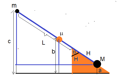

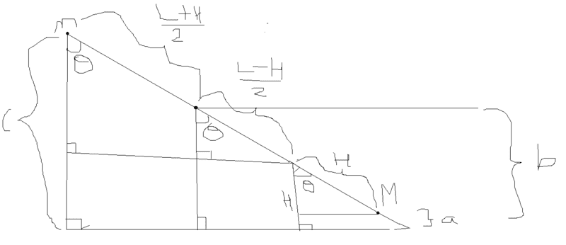

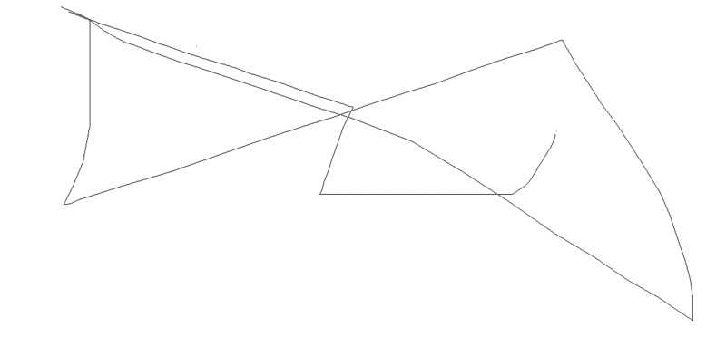

just for clarification i drew this please don't mind my ugly drawing skills thanks!
is this corrects?
vishnu 73 said:
oh you forgot the cosθ
but isn't this the heights i have i been saying since the start so is it correct? thanks!
The drawing is all right. So what is b? Where is cos(theta)?
cos theta is the vertical height from edge of blockade to b
that is b is
H + (L-H)/2 cosθ
that is b is
H + (L-H)/2 cosθ
correct at last.
