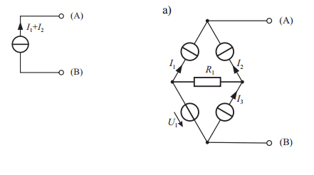

Iwas soving a problem and the question is to simplify the circuit . Ididnt understand how the whole circuit is the same as the sum of I1 and I2 and U1 (which is a voltage source ) and I3 and R1 don't play a role

Imagine there is an external load, represented by an additional resistor R (not shown) between A and B.
Looking at these sources (and their ghastly non-standard symbols) can you say how much current is leaving this circuit to flow into resistor R via the wire at A?
true its equal to i1 + i2

So that's the current leaving at A and going into the top of the load resistor, R.
Next, what would be an expression for current leaving the lower end of R to reenter the circuit at point B?

also I1 +I2
dontwannatellyou said:
also I1 +I2
So what is the voltage across the load resistor, R?
◉ Now, as a learning exercise, deduce what must be the voltage across the top left current source (the source supplying I1 ).
