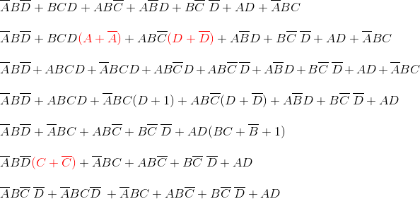

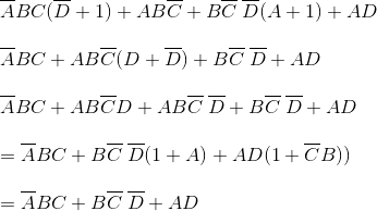

Simplify the Boolean expression :
Boolean expression: A-bar B D + B C D + A B C-bar + A B-bar D + B C-bar D-bar + A D + A-bar B C
[/B]
Here is my work :
Step-by-step Boolean algebra simplification in seven lines, each line rewriting the previous expression, with red highlighting on the terms being combined (C + C-bar, D + D-bar, A + A-bar).
Step-by-step simplification of a Boolean expression, with overlines marking complements, ending in the result A-bar BC + B-bar C-bar D-bar + AD.
Could someone check my answer please ?
  • Boolean expression: A-bar B D + B C D + A B C-bar + A B-bar D + B C-bar D-bar + A D + A-bar B C
Have you checked it with a Karnaugh Map yet?
We haven't covered it yet .
I get the same answer with an online solver. By the way, that seems to be a very difficult question so well done for solving it without using a Karnaugh map (which like Berkeman suggests is far superior).
