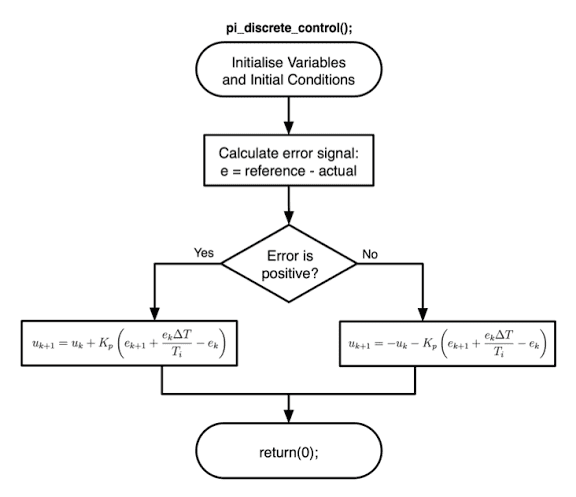

I've been looking to simulate a PI controller in SIMULINK without much success. You will be able to find a description of the above in the images located here: https://picasaweb.google.com/102197309611185157885/PIControlWithMatlabAndSIMULINK?authkey=Gv1sRgCOCnzvbm5PuNJA&feat=directlink.
I was able to use some of the SIMULINK supplied blocks to get started in simulating a PID(z) controller attached to a similar model of a DC motor with the feedback of dtheta (angular velocity in rad/s) passed to a zero-order-hold block. The input I used a speed reference (in rad/s again). I want to, however, replace the SIMULINK supplied block with a custom PI controller - see below:

(A) The first stage would involve modelling the above PI controller and my DC motor model. I tried a test today using MATLAB's supplied PID(z) block and with the ZOH on the d_theta feedback loop - it worked like a charm.
(B) once A is completed I'm wondering how I can add a PWM block between the controller and motor - again, I'd prefer if I could supply a model for the PWM controller itself rather than relying on the SIMULINK block - or should I not bother?
In this case, would the loop look something like:
Vref(t) ----(Diff)----------> [ PI(z) ] ------> ZOH ------> PWM --------> Motor -------------> to Diff, already in continuous time due to previous ZOH.
or
Vref(t) ----(Diff)----------> [ PI(z) ] ---------> PWM --------> Motor --------ZOH -----> to Diff
To make the simulation less boring I can connect a variable torque load to Kt inside the motor model by using one of the repeating sequence blocks - this will ensure the error signal has some serious work to do :)
**edit** - I tried this today and it failed miserably. I believe the whole PWM part could be avoided since it's just a linear representation of the control signal. It's just d_theta but expressed in terms of duty-ratio.

I found some s-function alternatives; you can find the code here:
https://gist.github.com/978493
I tried to simulate the first one (same as the last) in SIMULINK, but got a rather strange "flag==3 call must be a real vector of length 1" ?
