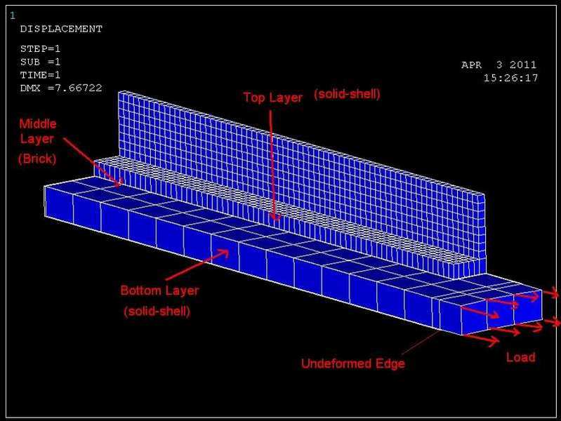

Im looking into the accuracy of using different element types to model a particular structure. As a simple approximation think of it as a beam split into 3 horizontal sections. Shown in the diagram as top, middle & bottom layer. (The middle layer is very thin!)
I have modeled the structure in ANSYS Mechanical and obtained the results using Solid Brick Elements. Now I am trying to create the same model in ANSYS Classic using a combination of Solid-Shell and 8-node brick elements.
I have all the loading conditions set up, but I'm having a problem with contact settings. In ANSYS Mechanical i used "bonded" symmetric contact on the areas in contact.
In APDL I am trying to use the contact wizard to do the same, but don't know the friction coefficeints that would be comparable to that of the "bonded" contact in mechanical. The model is not deforming how i would expect, if all the layers are bonded the structure should experience bending stresses and displacement on the LHS rather than the RHS.
Finite element mesh of a three-layer beam in ANSYS, with a thin middle brick layer between a bottom solid-shell layer and a top solid-shell layer; the bottom layer's free end has arrows marking the applied load and the undeformed edge.
I have a feeling my contact is not set up correctly. Any tips? ideas?

Hi,
So i solved the above problem. I had forgotten to change the contact settings from "Standard" to "Bonded (always)" in the contact wizard.
However, that didnt solve my problem as i was still getting large errors. So i thought i would do a test to see if it was my contact settings. I had created an all solid model in ANSYS Mechanical, so i thought i'd recreate this in APDL to see if i could get matching answers. After many trials, i still can't get it correct =( The deformation is spot on, but when looking at Equivalent Stress.. i get errors of upto 15%!
I am using currently using Nodal components (surface-Surface) and the contact wizard to create the contact. Is there another way i can try doing this?

well I am currently trying to solve a wood-dowel project using contact element. The problem for the error maybe due to the parameters and equation that you select. make sure that if you use bonded contact the contact algorithm is" MPC" because MPC has a good convergence behavior (with few equilibrium iterations) if you change the standard to bonded (always) also check to change the contact algorithm to MPC, that fits better. and change your normal stiffness to 1 and see if it helps.
