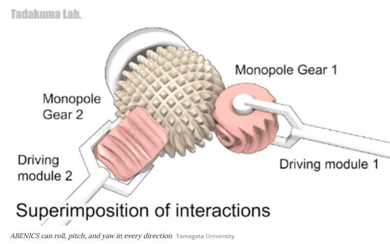

Actually I am trying to implement the spherical gear mechanism which was invented as ABENICS..so here the spherical gear is made hollow and I am placing the reaction wheel inside it

ABENICS
Interesting mechanism!
Diagram of the ABENICS spherical joint mechanism showing a textured ball driven by two pink monopole gears on separate driving modules, with the caption "Superimposition of interactions".
https://newatlas.com/technology/abenics-versatile-active-ball-joint-gear/
