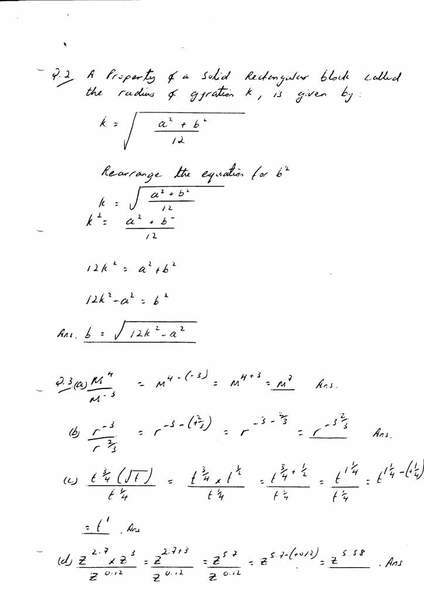

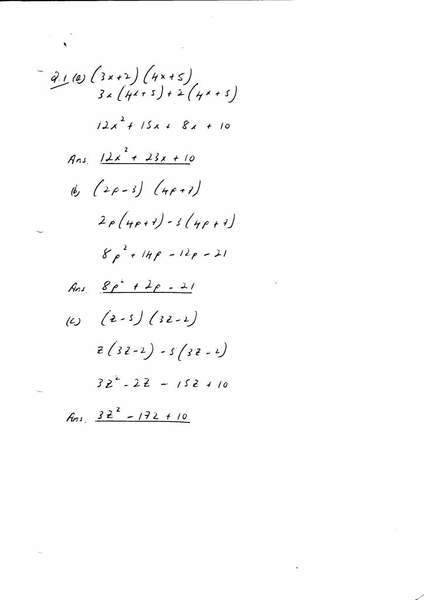

Guys I have an assigment to hand in I am back at college again. Mature student
so as this might be simple for some it sometimes is not for me(out of school 10 years)
I have uploaded 3 pages, questions 1,2,3 I have completed. but I just need to have them checked to see if they are correct.
And then Question 4 I am totally lost on what to do.
I would be really grateful for any help
thank you

  • Handwritten working for question 1 parts (a) to (c), expanding products of binomials such as (3x+2)(4x+5), (2p-3)(4p+7) and (2-5)(32-4), with answers 12x^2 + 23x + 10, 8p^2 + 2p - 21 and 32^2 - 17z + 10.
  • Handwritten working on lined paper for question 2.2: the radius of gyration k = sqrt((a^2 + b^2)/12) rearranged to b = sqrt(12k^2 - a^2), followed by three index-law simplifications (a)-(d) ending in answers marked Ans.

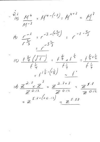

Hi Mark thanks for replying I have uploaded the first 2 documents again, sorry about my writing it's terrible
  • Handwritten expansion of three binomial products by hand: (3x+2)(4x+5) = 12x^2 + 23x + 10; (2P-3)(4P+7) = 8P^2 + 14P - 12P - 21; (Z-5)(3Z-2) = 3Z^2 - 17Z - 10.
  • Handwritten derivation: Q2.2 A property of a solid rectangular block called the radius of gyration k is given by k = sqrt((a^2 + b^2)/12). Rearranged for b^2: k^2 = (a^2 + b^2)/12, 12k^2 = a^2 + b^2, b^2 = 12k^2 - a^2, b = sqrt(12k^2 - a^2).
  • Handwritten exponent-rule working for parts (a) to (d): M^4/M^-3 = M^7; r^-3/r^(2/3) = r^(-3 2/3); t^(3/4)(sqrt t)/t^(1/4) = t; Z^2.7 x Z^3/Z^0.12 = Z^5.58 with a crossed-out step.
It would be helpful if you could type in what you have so that we don't have to open an attachment.
In the first file, 1a is correct, 1b is correct as far as it goes (combine the two middle terms), and 1c has an incorrect term ( (-5)(-2) isn't -10). Also, you should insert = signs between any two expressions that are equal. Your work doesn't show any of them, and it should.
In the second file, there are actually two solutions; b = +/-sqrt(12k^2 - a^2). It might be that it is physically impossible for b to be negative, but unless you know that, you should show both solutions.
You didn't mention it, but your third file is different this time from the one posted originally. Parts a, c, and d are fine, and part b is technically correct, but you shouldn't write exponents as mixed numbers. Instead of writing the exponent as -3 2/3, write it as -11/3. Same goes for part c. Don't write the exponent as 1 1/4; write it as 5/4.

Hi Mark yeah I was in a rush to write it down again before you went offline.So I made a few mistakes, but my original work is correct from what you say. Question 2 I will work out for both - and + , and also thanks for telling me the correct way to write exponents.
That has helped me a lot thanks very much
