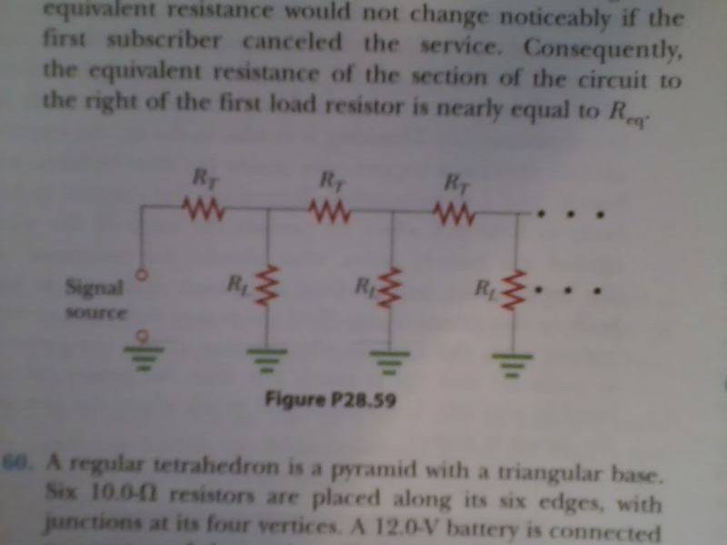

Can someone explain why the source must also be hooked up to ground. I know it completes the circuit but what's the point? Why wouldn't current flow without it? Since the line is at a positive potential then there is a resistor(acting as a house) then house is connected to ground. Seems as if current should flow from high to low potential.

Your link requires a secure sign-in and password. Can you post is in the clear somewhere else?
Yes, in this circuit the source has to be grounded. Otherwise the circuit is not complete, and no current can flow through the signal source.
Alternately, just draw a wire across the bottom of the signal source and the load resistors, and get rid of the ground symbols. They just represent a common connection in this problem anyway.
Think of the signal source like it was a battery. You need to connect to both the + and - terminals of a battery to get any current out of it, right?

I don't know much about Van de Graff generators, but no, without a complete circuit, no current will flow. Keep thinking about my battery illustration. If you connect only one end of a battery to anything, nothing happens, right?

Look at the figure at the wikipedia page for the VdG generator:
http://en.wikipedia.org/wiki/Van_de_Graff_generator
It shows a complete circuit, right? The electrons get pumped to "ground" or the - return lead. The arc that gets drawn across the gap flows as the same current all throughout the circuit.

Looking at the figure at the wikipedia article, it does not matter a bit if you hook "ground" or "Earth" or a pink poodle to the - connection. The current flows around the closed path shown in the figure.
