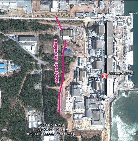

They should have built one or two diesel generator buildings with the capacity to run any of the reactor pumps from any of the diesel generators. Those generator building should have been built on top of the nearby hill, a hundred feet above the water.
And to add insult to injury, that 100' hill you suggest - only 220 meters west of the reactors the elevation is 100'.
Yep they had to cut down the hill to build the reactor site. By cutting down to close to sea level, they ensured a future catastrophe. We are now witnessing it.

(1) Using modern Gen III+ reactors
(2) More realistic tsunami calculations resulting in a higher sea wall
(3) Placing diesel generators and switching equipment in a safer location
(4) Armoring diesel generators in current location like the European EPR reactors.
(5) Having additional on-site emergency generators that were compatible with current equipment
(6) Having a NEST-like emergency team with prearranged, prepositioned, and preallocated assets to handle civil reactor emergencies.
(7) Longer battery life for reactor core isolation cooling system
We must keep in mind the main technical cause of the problem: a single backup which was placed in a vulnerable location. Despite the nuclear mantra of "we have backup systems for our backup systems", in reality there was a single backup.
