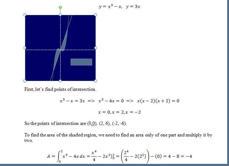

Sketch the region enclosed by the given curves. Decide
whether to integrate with respect to x or y. Draw a typical approximating
rectangle and label its height and width. Then find the
area of the region
I got a negative answer again :(

Same answer as before. You subtract the curve on the top minus the curve on the bottom and integrate. Not vice versa.

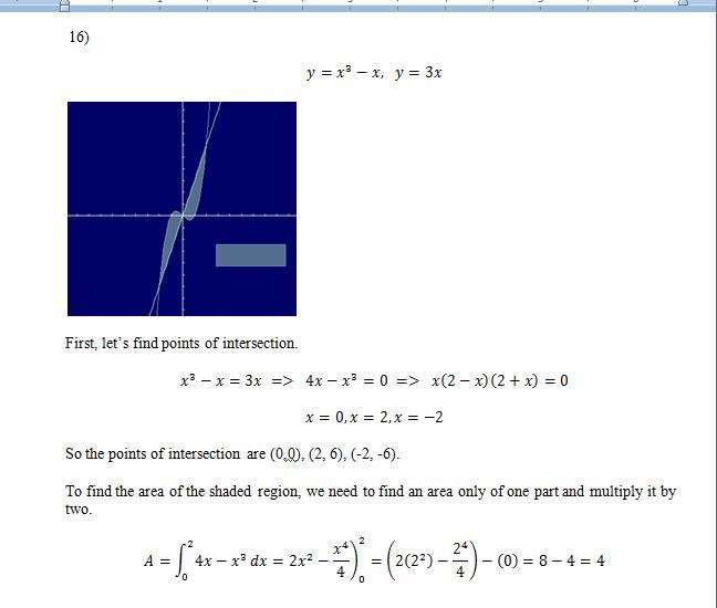

Is this right?

Yes, don't forget you were going to multiply by two. Are you sure you know why you can do that?
