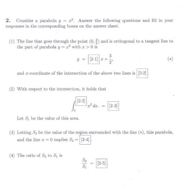

Printed worksheet, question 2 on the parabola y = x^2, with boxed answer blanks for parts (1) to (4) including the line y = -2x + 3/2 and the integral of x^2 from 0 to 1.
I'm confused avout questions 2-3.
The answers for 2-2 is 1
So the answer for 2-3 is $$\frac{1}{3}$$
But, how the area looks like? Because $$ x^2 $$ will be an open curve upside? There's no boundary for above side.
  • Printed worksheet, question 2 on the parabola y = x^2, with boxed answer blanks for parts (1) to (4) including the line y = -2x + 3/2 and the integral of x^2 from 0 to 1.
Can you show us how you got to ##x_0=1## as intersection point? What did you get for the line equation ##s(x)= m_{2.1}x +\dfrac{3}{2}## and what for the tangent ##t(x)=m_t + b_t\,?## What is the slope ##m_t## of the tangent and where does it intersect the ##y-##axis at ##b_t\,##?
##s(x)## should bound the open parabola from above. Try to draw your results.

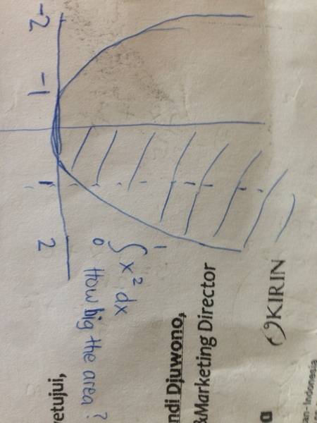

What I don't get is, how the area of S1(x) looks like?
Handwritten sketch, rotated sideways, of a shaded region bounded by two curves and a horizontal line, with the integral of x squared dx from 0 to 1 written beside it and the question how big the area is.
I'm sorry, i cannot rotate it..

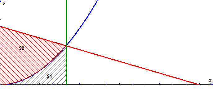

This is the area ##S_2## we are looking for, you only have to bound it from above by ##L_2(x)=-\frac{1}{2}+\frac{3}{2}## which goes from left to right and from ##(0,\frac{3}{2})## to ##(3,0)##. ##S_1## is below the parabola, not above, but we already know ##S_1=\frac{1}{3}##.

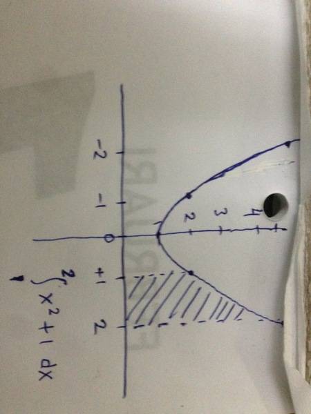

So for example, we have to find integral of x^2 + 1 with vertices 1, 2
The area is below the parabola?

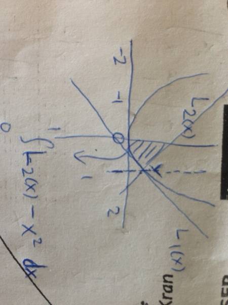

  • Hand-drawn sketch of the region between curves L2(x) and L1(x) with the shaded area bounded by the y-axis, x = 1 and x = 2, with the integral of L2(x) minus x squared dx written below.
##S_1## is below (outside, green) the parabola, ##S_2## is above (inside, red). We already know that ##S_1=\dfrac{1}{3}##.
Now there are three possibilities to calculate ##S_2##:
  • in three steps with the help of two triangles and ##S_1##
  • in two steps with ##\int_0^1 L_2(x)dx## and ##S_1##
  • directly in one step with the difference function of ##L_2## and the parabola.
I don't see why you move the parabola upwards with new boundaries. If you know the formula of the area of triangles, you can use the first method, if you like to integrate, then the other two are fine. The second explicitly uses the previous result of ##S_1## and the third calculates everything new in one step. It's used here, that integrals as well as areas can be added: ##\int f(x)dx \pm \int g(x)dx = \int (f(x) \pm g(x)) dx##.
Of course one has to be cautious as an integral describes an oriented volume (area), i.e. it can be negative whereas an area is not, but this doesn't play a role here. I only mention it, to prevent others from over-correcting me, and for you to be aware of the difference between an area and an integral.

i am sorry, i uploaded wrong picture. Is this right? I understand your explanation. If the area is negative (below x coordinates) there are moment necessary to give negative sign.

Yes, that has been the function and integral in your previous post. I don't understand where it comes from and what it should be. I read question 2-3 as follows (although the word "implies" is a bit strange here):
"Letting ##S_2## be the value of the region with the line (*), this parabola and the line ##x=0## implies ##S_2=[{2-4}]##"
Letting ##S_2## be the value of the region ## \leftrightarrow ## area
with the line (*) ## \leftrightarrow ## ##L_2(x)=y= -\dfrac{1}{2} \cdot x+\dfrac{3}{2}##, i.e. the red line in my picture
this parabola ## \leftrightarrow ## ##p(x)=y=x^2##. i.e. the blue curve in my picture
and the line ##x=0## ## \leftrightarrow ## i.e. the ##y-##axis
implies ##S_2=[{2-4}]## ## \leftrightarrow ## i.e. the red area labeled with ##S_2## in my picture
There are several ways to calculate ##S_2## (see post #9). As we already know the area of ##S_1## (green area in my picture labeled with ##S_1##) it might be easiest to use ##S_1## and some triangles and additions / subtractions. But as an area you might as well write it as an integral ##S_2= \int_0^1 f(x)dx## where ##f(x)## is composed by the line ##L_2(x)## and the parabola ##p(x)##.

Sorry, i meant as an example that to find the area of x^2 + 1. So, the parabola i drew is right?
Yes.
And as a side note for what I've meant by an oriented volume: In your example you get ##\int_1^2 (x^2+1)dx= \frac{10}{3}## and ##\int_2^1 (x^2+1)dx= -\frac{10}{3}## although the area is the same, namely ##|\,\int_2^1 (x^2+1)dx \,| = + \frac{10}{3}##. The integral distinguishes the direction in which the area is measured. It is called orientation or oriented volume (here area).
