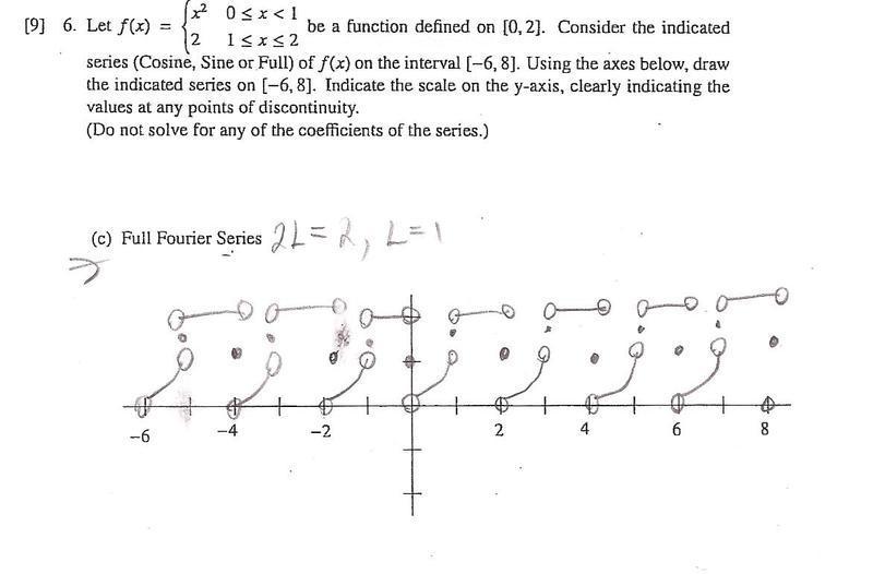

See figure attached.
See figure attached for my attempt.
Is this the correct way to sketch the full Fourier series of the given function?
If not, what am I doing wrong/misunderstanding?
Thanks again!

It looks good. Don't forget to label the y-axis showing the scale (numbers).
