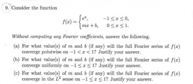

I am working on a simple PDE problem on full Fourier series like this:
Given this piecewise function,
##f(x) =
\begin{cases}
e^x, &-1 \leq x \leq 0 \\
mx + b, &0 \leq x \leq 1.\\
\end{cases}##​
Without computing any Fourier coefficients, find any values of ##m## and ##b##, if there is any, that will make ##f(x)## converge pointwise on ##-1 < x < 1## with its full Fourier series.
I know for sure that if ##f(x)## is to converge pointwise with its full Fourier series, then ##f(x)## has to be piecewise smooth, meaning that each piece of ##f(x)## has to be differentiable.
(a) Is this the right way to go?
(b) If it is, how do you prove ##e^x## and ##mx + b## differentiable? By proving ##f'(x) = \lim_{x \to c}\frac{f(x) - f(c)}{x - c}## exists?
Thank you for your time.

Your statement " ... ##f(x)## has to be piecewise smooth..." is false: it does not have to be piecewise smooth. It just has to obey the Dirichlet conditions; see, eg.,
http://en.wikipedia.org/wiki/Dirichlet_conditions . These do not involve smoothness or differentiablility.
So, with no restrictions on ##m,b## your function's Fourier series will converge pointwise on ##-1 \leq x \leq 1##, and will converge to ##f(x)## for ##-1 < x < 1, x \neq 0##. For some ##m,b## it will also converge to ##f(0)## when ##x = 0##, but for some other choices of ##m,b## it will converge to something else at ##x = 0## (but still converge).
@A.Magnus: I would almost bet that the original problem wants you to find m and b such that the FS converges pointwise to f(x). Otherwise there isn't much point to the problem. That would require specific values of m and b.
I have uploaded the page that has the original problem 9, see the attached file. The text is "Introduction to Applied PDE" by John Davis, let me know if I got it very wrong in the first place, I will happily stand to be corrected. Also do let me know how should I go ahead if I was wrong. Thank you!
PS:The text is extremely cut and dry, on top of that this is an online class, we get only reading assignments and homework, no lectures. Never complaining, so I take this site as crowd-teaching forum! :smile:

The pdf displays upside-down on my screen, and I cannot rotate it (and so cannot read it). Anyway, have you read post #8?

Ray, here is the corrected file. Feel free to
Homework problem 9: piecewise function f(x) = e^x for -1 ≤ x ≤ 0 and mx + b for 0 ≤ x ≤ 1, followed by parts (a), (b) and (c) on pointwise, uniform and L² convergence of its full Fourier series.
crowd-teach me. Thanks.

Ray, here is what I copy down verbatim from the John Davis' text, page 88:
Theorem 3.2 (Pointwise Convergence of Fourier Series).
If ##f## is piecewise smooth on ##(-l, l)##, then the Fourier series of ##f## given by the above (3.8) converges pointwise on ##(-l, l)## and
##\frac{1}{2} a_0 + \sum_{n=1}^{\infty} [a_n \cos (n \pi x/l) + b_n \sin(n \pi x/l] = \frac{f(x^+) + f(x^-)}{2}, \quad x \in (-l, l).##
Here, ##f(x^+) := \lim_{w \to x^+} f(w)## and ##f(x^-) := \lim_{w \to x^-} f(w)##, and (3.8) is referring to this: ##f(x) = \frac{1}{2} a_0 + \sum_{n=1}^{\infty} [a_n \cos (n \pi x/l) + b_n \sin(n \pi x/l], \quad -l < x < l.##
Let me know what I got wrong. Thanks again and again.
