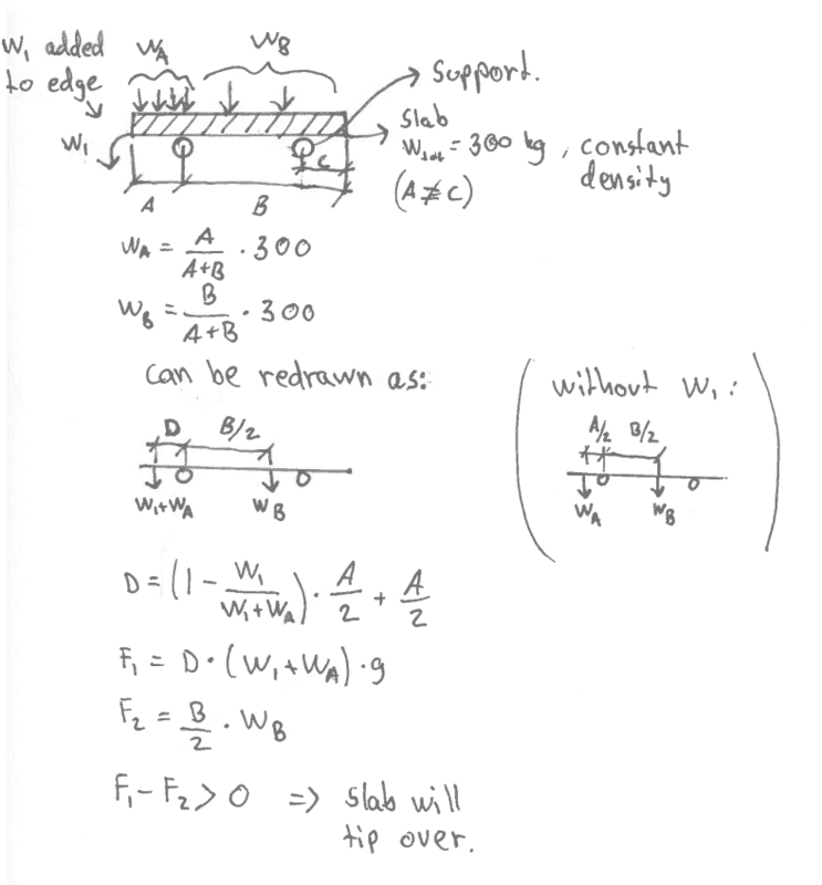

A slab is placed on two supports. At one edge, a weight is added. How large can the weight be before the slab tips over? The slab weighs 300 kg, and the density is constant. See image for attempted solution and a drawing of the slab.
F_1*d_1=F_2*d_2
Hi,
My attempted solution is in the image:
I choose the edge on the left side, but the solution should be similar on both sides (just substitute C for A).
(I missed to multiply by "g" in F_2.)
Is this the correct way of thinking? I'm not sure about the distance "D".

I can't follow what you do on the left side:
On the right side you calculate a moment (not a force, so the use of the symbol F is misleading) WB * g * B/2
If I work out your expression for F1 I get WA * g * A + W1 * g * A/2
and it should be the other way around...

Thank you.
Yeah, made a mistake and wrote it as a force.
Are you saying it should be:
WA * g * A/2 + W1 * g * A ?
What I did on the left side, or what I tried to do, was to add the extra lever distance resulting from the weight W1, by calcuting the ratio of W1 to W1+WA and adding it to A/2 - if this makes any sense?
I suppose it makes sense but was processed erroneously.
Anyway, you should work with the sum of moments without having to fall back to shifting lever distances ! Much less error-prone :wink:
Would it requie more or less weight if W1 was placed on the corner of the slab? Is it dependent on the width?
For the direction we did the analysis in it makes no difference. For a direction into the paper we have no information
