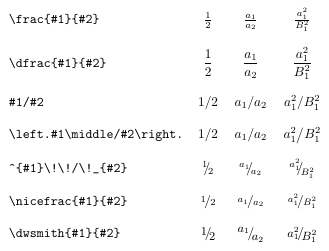

Here's an overview, using MiKTeX.
http://www.mathhelpboards.com/attachment.php?attachmentid=875

Anyway, here's the overview as far as it renders here.
\newcommand{\slfrac}[2] { \left.#1\middle/#2\right. }
\verb|\newcommand{\ILS}[2] { ^{#1}\!\!/\!_{#2} }| \\
\verb|\newcommand{\dILS}[2] { ^{ \displaystyle #1}\!\!/\!_{ \displaystyle #2} }| \\
\verb|\newcommand{\xILS}[2] { \left. ^{ \displaystyle #1}\!\!\middle/\!_{ \displaystyle #2} \right. }| \\
\begin{array}{|l|ccc|}
\hline \\
\verb|\frac{#1}{#2}| & \frac{1}{2} & \frac{a_1}{a_2} & \frac{a_1^2}{B_1^2} \\ \\
\verb|\dfrac{#1}{#2}| & \dfrac{1}{2} & \dfrac{a_1}{a_2} & \dfrac{a_1^2}{B_1^2} \\ \\
\verb|#1/#2| & 1/2 & a_1/a_2 & a_1^2/B_1^2 \\ \\
\verb|\left.#1\middle/#2\right.| & \slfrac{1}{2} & \slfrac{a_1}{a_2} & \slfrac{a_1^2}{B_1^2}\\ \\
\verb|\ILS{#1}{#2}| & \ILS{1}{2} & \ILS{a_1}{a_2} & \ILS{a_1^2}{B_1^2}\\ \\
\verb|\dILS{#1}{#2}| & \dILS{1}{2} & \dILS{a_1}{a_2} & \dILS{a_1^2}{B_1^2}\\
\verb|\xILS{#1}{#2}| & \xILS{1}{2} & \xILS{a_1}{a_2} & \xILS{a_1^2}{B_1^2}\\
\hline
\end{array}
Let me retry the attachment.
I was fiddling with it before to get it to show neatly.
http://www.mathhelpboards.com/attachment.php?attachmentid=877&d=1370685379
So before, the attachment just showed up as a "couldn't load image" error at that spot before. Not sure what happened there. At any rate, I can see your latest post just fine. Thank you for the table! I stand by my aesthetic opinion here, so \middle/ seems to work best for me. I think that's what I'm going to be using from now on, if it comes up; I think it will look better for nested fractions too.
