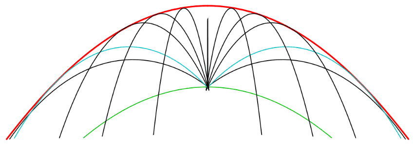

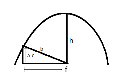

I used another approach geometrical one
so we know sum of distance from each point from focus and height is same in parabola also assuming the focus to be a cannon by same velocity u we can reach any point in parabola if angle is changed so h+h = b+a-c
thus u = √2gh substituting h we get u=√g(b+a-c)
How do you know the focus is at the height ##c##?
I thought that velocity is constant so just by changing angle we can reach any point I took help of this diagram
its from projectile motion and just by changing angle its touching every part of parabola .
except from 0-45
