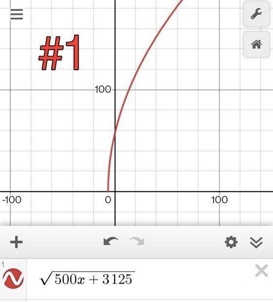

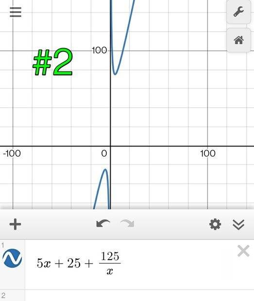

Uh, so, I'll use a different example.
If I substituted in 25 m/s for v, in v^2 = u^2 + 2as, where s = 25t + 125, I get graph #1. But instead if I were to substitute in u-gt for v, I'd get graph #2(that function has a minima).
And my question was, do we substitute u-gt for v, to get a function that has a minima?
No. You get a point. There is no function there. No free variable.
Isn't a function literally right there? That's not a point... anyways that's besides the point(get it?)... Is the answer to my question a yes or no?(although still how does that function become a point...?)
##y = x^2## is a function. ##(1, 4)## is a point that lies on the graph of that function. If you specify ##y = 1## or ##x = 4##, then you are talking about a point and not a function.
You can differentiate a function: ##y' = 2x##, but you can't differentiate a point. You can, however, evaluate the derivative at a point ##y'(1) = 2##.

Some functions, like linear ones, like u = 10t + 25, don't have a minima.(i got this from v = u +at where i fixed the value of v to 25 m/s) Other functions like 125/t + 25 + 5t do have a minima. So, instead of fixing v to a certain value, if we substitute v = sqrt(u^2 + 2as) for v in v = u +at where s = 25t + 125, and rearrange for initial velocity u, we get u = 125/t + 25 + 5t, which does have a minima. So, my final question was, do we substitute in something different for v(in this case it was sqrt(u^2 + 2as)) instead of a fixed value like 25 to ensure that the function 𝘩𝘢𝘴 𝘢 𝘮𝘪𝘯𝘪𝘮𝘢. I don't think this has anything to do with t or T, which I didn't keep track of, I'm sorry, but please, just answer this question
It looks like that's what you did, so yes. But I would use the word "create" rather than "ensure".
