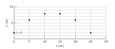

A track meet is held on a planet in a distant solar system. A shot-putter releases a shot at a point 2.0 m above ground level. A stroboscopic plot of the position of the shot is shown in the figure, where the readings are 0.56 s apart and the shot is released at time t = 0.
(a) What is the initial velocity of the shot in unit-vector notation?
(b) What is the magnitude of the free-fall acceleration on the planet?
(c) How long after it is released does the shot reach the ground?
(d) If an identical throw of the shot is made on the surface of Earth, how long after it is released does it reach the ground?

Im really stuck with this problem ! any help would be much appreciated

There are more relevant equations. What are the equations for position and velocity as a function of time?

you mean the vertical equations ? SUVAT ?

The equations of motion, so SUVAT will do.
S=ut+1/2at^2? can that find the acceleration for part B? what confuses me most is unit vector notation I don't understand how you put in into that form

Decompose the motion into x and y. (There is no coupling between the two.)
Because you have two unknown variables, you have to list two equations using basic physics formula for y direction. (simultaneous equation)

This form is for y direction.
