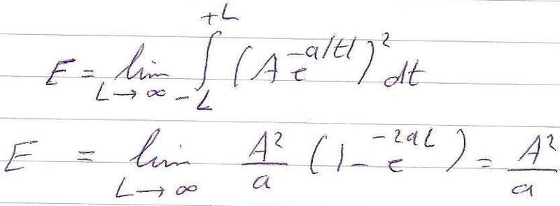

Hello.I actually didn't know exactly how do we get to the second line with this integration.
Integrate this by splitting up the interval on which it is done:
[tex]\int^L_{-L} f(t) dt = \int^L_{0} f(t) dt + \int^0_{-L} f(-t) dt[/tex]
Then you'll be able to remove the '| |' and integrate it normally. When you're done with the integration, just substitute in the limits and let L approach infinity.
