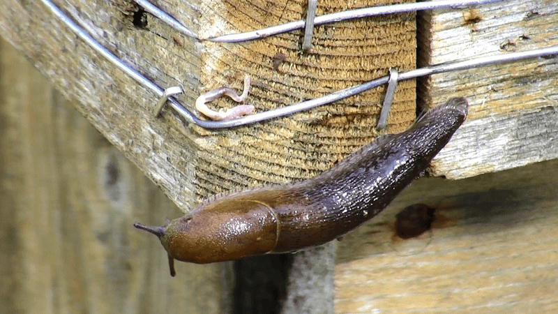

There is a permanent slug infestation in our garden.
Just collecting/disposing them is futile: they have several 'endless' sources of reinforcements nearby.
Needs some means to protect some key areas.
There is a permanent slug infestation in our garden and collecting/disposing them is just not a solution: thus, I need some means to protect at least some important areas.
After some deliberation I've decided to give a try to these electric 'snail fences'.
Something for long term, 7/24 maintenance-free operation, with as much DIY as convenient => it'll be some repurposed PV+battery system providing some 6-9V voltage for the wires.
I don't know the current yet. It's just an experiment at this point.
After some further deliberation these solar lamps (not the decorative type) come to my attention. It has the PV, the charge circuitry, battery, some kind of output and an water-resistant casing in one go.
What's lacking is my experience. For example - can these be modified to provide output while still charging? Any chance to set the output voltage?
Any thoughts, ideas?
Thanks in advance.

Actually, no. It's about the slug touching the second wire as it bridges the wires. So: current at the point of contact.
I'm relying on available 'resources' like youtube and gardening blogs at this point (:wink:), so it's kind of uncertain but the usual voltage is 9V and around due the available battery. 12V often mentioned as already deadly. I've seen only a few mentions about 5V, but none below.

How about simple battery power? Take a look at: Electric Garden Slug Fence
The author claims to get around-the-clock slug protection for a raised bed (area unspecified) over a full growing season, all from just one 9V battery.

Half joking, half serious suggestions:
-Get some runner ducks. Apparently they love slugs.
-Put up some nesting spots for wrens. Apparently they too love slugs. Benefits the neighbors, too, helping thin out the reinforcements.
That said, I'm in the camp of the electric fence. It's simple, relatively cheap, and some designs are solar powered, so you can set it and forget it.
Although... what about the little ones? Shorter than the gap between the contacts? Is the slime conductive enough to zap them, or will they just gleefully slime across them one at a time?
