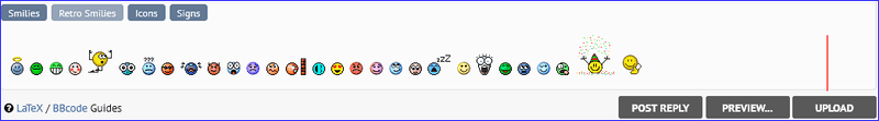

I'd post pictures of the completed project, but I am not a gold member, and do not have privileges to post pics.
I don't think you need to be a gold member to post pictures... don't you have the UPLOAD button in you're reply box ?
  • #35
Hmmm, I guess I do. I'll grab some pictures when I am deploying it in the field, or maybe when I am installing the switch I have yet to source...
