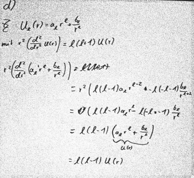

I got the the radial part of the Laplace-Equation:
[itex]r^2(\frac{d^2}{dr^2}U(r))=l(l+1)U(r)[/itex]
Now I should show that the following solves the equation:
[itex]a_l*r^l+\frac{b_l}{r^l}[/itex]
The problem is that I got l(l-1) instead of l(l+1) :(
Hello, and welcome to PF!
The expression on the left is incorrect. See http://physicspages.com/2012/01/20/laplaces-equation-spherical-coordinates/ for Laplace's equation in spherical coordinates.
Sorry for the late answer. the ansatz was wrong, instead of [itex]a_r*r^l+\frac{b_l}{r^l}[/itex] it has to be:
[itex]a_r*r^l+\frac{b_l}{r^{l+1}}[/itex]
