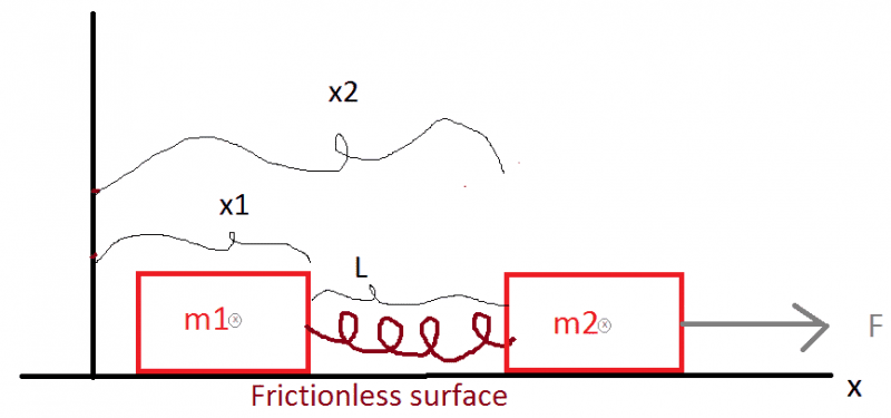

Have to boxes on a frictionless surface, connected with a massless spring with unstrecht length L and spring constant k. The boxes have mass m1 and m2 and ca be regarded as point masses.
The two variables x1 and x2 is the position of the boxes at the location where the spring are attached.
I try to set up the differential equation for this problem, but cannot manage to to that.
I think that when the force is put on, box 2 will accelerate faster than box 1 in the start, until the spring have streched enough to balacne the force F?
F_spring = kdx
x1'' = k(x2-x1-L)
x2'' = -k(x2-x1-L) +F

I think you're doing just fine in setting up the differential equations, except you want a force on the left too: m1x1'' etc.
How does the exercise continue ? Or is all you have to do this setting up the differential equations ?
Re accelerations: you can now write expressions for a1 and a2 and that means you can also write the condition for a1 < a2

Yes the equation should be like this:
m1*x1'' = k(x2-x1-L)
m2*x2'' = -k(x2-x1-L) +F

Doesn't it look tempting to add the two equations ?
Probably. Do be honest, my math is so rusty that I need to spent some time to search for a solution method. Do you have any tips on where to start?
Yes, add the two equations :)
I have added the two equation, and to my supprise the spring data dissapeard
[itex]m_1\frac{d^2x_1}{dt^2}+m_2\frac{d^2x_2}{dt^2}=F[/itex]
I really do not understand this problem any more.
I will believe that that the acceleration of box 1 will start from zero and gradually increase to a = F/(m1+m2) and that the spring constant will decide how fast this will happened.
What will happened with this system if a force F is suddently put on box 2?
That is exactly what you are to find out in this exercise !
And, of course, I don't want to spoil the fun of such a discovery.
But what you have found already is that this system of two masses, connected by a spring (the spring force is an internal force in this system) behaves as a mass ##m_1+m_2## located at its center of mass under the influence of the external force: $$m_1\frac{d^2x_1}{dt^2}+m_2\frac{d^2x_2}{dt^2}=F\ \ \Rightarrow\ \ (m_1+m_2)\;{m_1\frac{d^2x_1}{dt^2}+m_2\frac{d^2x_2}{dt^2}\over m_1 + m_2} = F$$With coordinate of center of mass $$\xi \equiv {m_1x_1 + m_2 x_2 \over m_1 + m_2}\;,$$what do you get ?

So I actually get with this:
##(m_1+m_2) \frac{d^2}{dt^2} \left( \frac{ m_1x_1 +m_2x_2 }{m_1+m_2 } \right) = F##
Changing to center of gravity:
##(m_1+m_2) \frac{d^2\xi }{dt^2} = F##
Which have this solution
##\xi(t) = \frac{F}{2(m_1+m_2)}t^2##
But I really do not understand how to get the solution I want from this.

##\xi(t) = {1\over 2} \frac{F}{(m_1+m_2)}t^2## still needs a ##+ \xi(0)##, which is not zero, to satisfy ##x_1(0) = 0## and ##x_2(0) = L##.
Yes that is true. With ##x_1(0)=0## and ##x_2(0) =L ## we got:
##\xi(t) = {m_2L\over m_1+m_2} {1\over 2} + \frac{F}{(m_1+m_2)}t^2##
But now I have to find out how to get from this, to the position of ##x_1## and ##x_2## as a function of time. Have to think..
You have a solution for one linear comination of the two x. That gives one equation with two unknowns. You need one more to establish both. Most likely one that has to do with the spring ...
Either that or one of the original two equations.

I would rewrite your original differential equation (either one) in terms of the distance from the common mass centre to one of the masses.
Yes, I have come to that conclusion. Now I only have to figure out how these equation look like. Will be back when I have something:)
